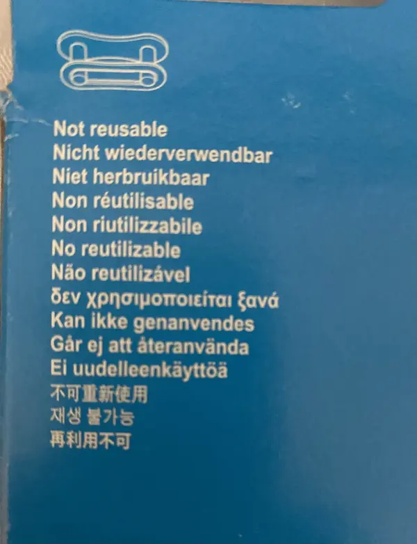

Thanks for the replies. On further investigation, Shimano say these links are not reusable.
I have the Park chain splitter and chain pliers (for a regular style quick link) but they don’t work on this Shimano design.
I think I’ll take @eric_james advice and bin it!
