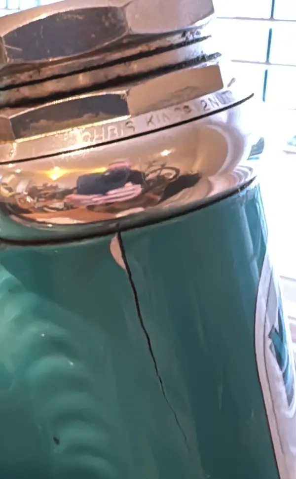

It’s super clean - remarkably so. But it’s a 92 and inevitably it’s cracked. Not badly though so I’m pretty sure either FTW or Dan can work their magic on this and it only needs a repair rather than a a replacement HT. ST is absolutely fine. Actually bought this ARC because I knew someone who was looking for one and I figured this would have been perfect for them, but the timing wasn’t right for them so I decided to keep it, do another ARC build, rescue it myself and avoid 3DV.

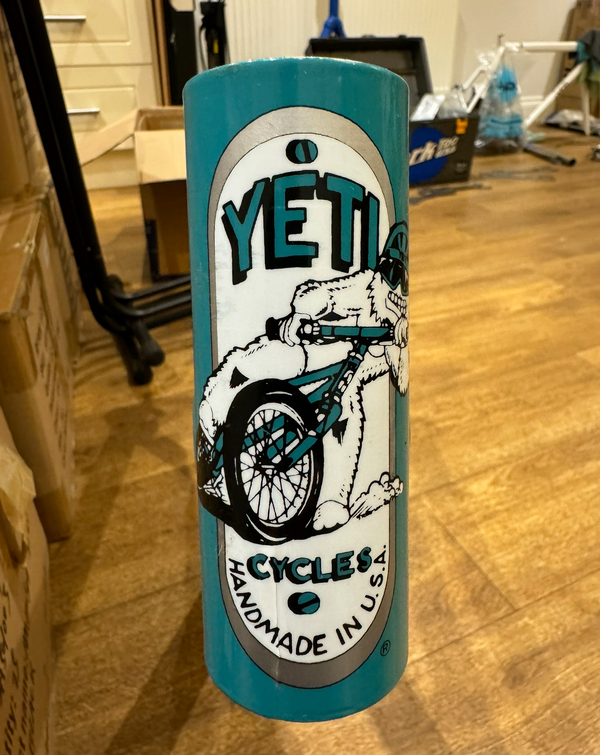

It’s quite an early ARC - I need to dig the serial number out. Was on display in Bromley Bike for a long time in 92 - then bought early 93. The guy also had a FRO. He said the frame is exactly as he bought it so it looks like Yeti/Bromley were selling some custom painted ARC’s back then - it’s got the painters name on there so will update when I get it back.
This is how I received it.

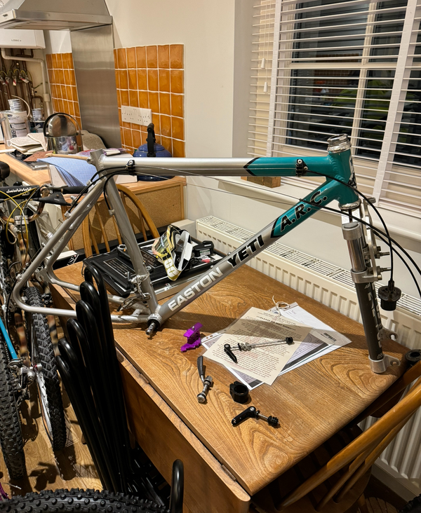

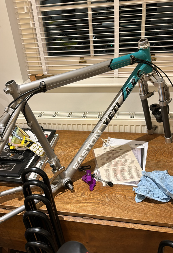

But I’ve already started pulling some bits together. I think I’m going to go classic black with this one…

Lovely - but that’s one hell of a HT crack. How do you repair/mend that? Do you replace the whole tube or do some clever welding and filing? Asking out of genuine interest as not that experienced with Alu repairs.
Clever welding on this occasion, tho you can also replace the HT if you wanted to. I wanted to keep it original so was keen to repair rather than replace. I’ll share some pics at some point

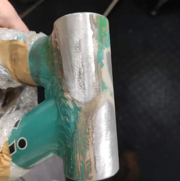

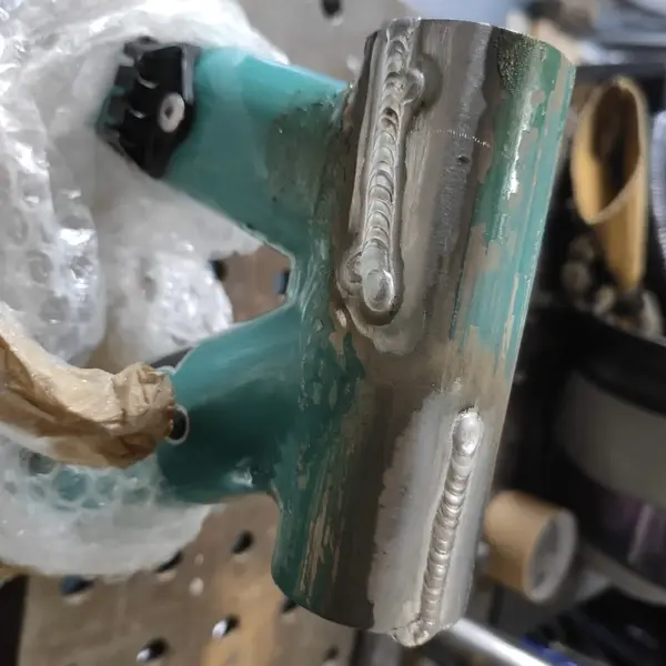

So Dan has worked his magic 👍
We wanted to ‘save’ the headtube - and avoid interfering with the TT/ST/HT weld junction.
Looks like we managed it 💪
Dan stripped the paint, apparently there was some seriously solid primer under there 😕
He then traced the cracks, v-cut, prepped, welded and finished.
Now it’s off to Al at FatCreations for some touch up work.
