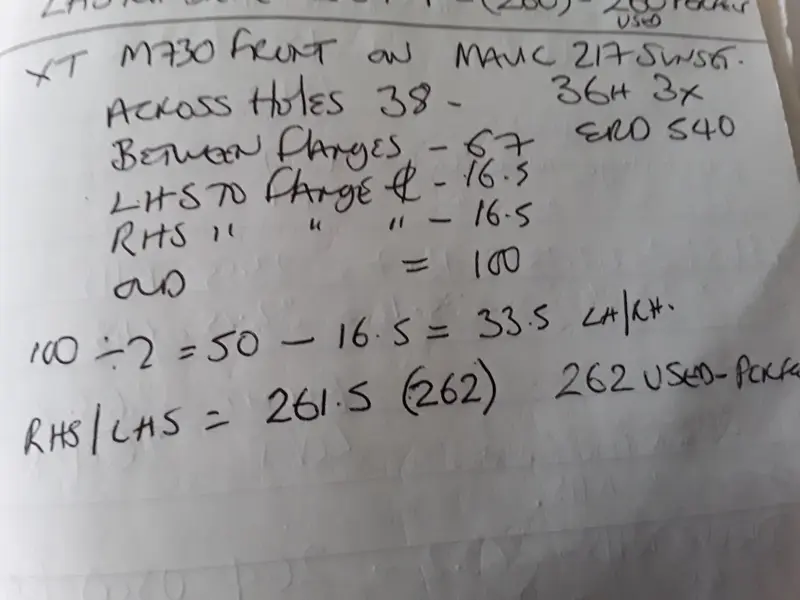

Tootyred Old School Grand Master Feedback View Apr 23, 2024 #4 217 sunsets on standard shimano hub was 262mm front 3x. Erd 540 Cant give you a rear as it was a specially spaced hub. But you can probably now work that out... Attachments 17138914145425120396304820154039.jpg 296.1 KB · Views: 9
Tootyred Old School Grand Master Feedback View Apr 23, 2024 #6 Oh....i missed that! Good catch....sorry.
