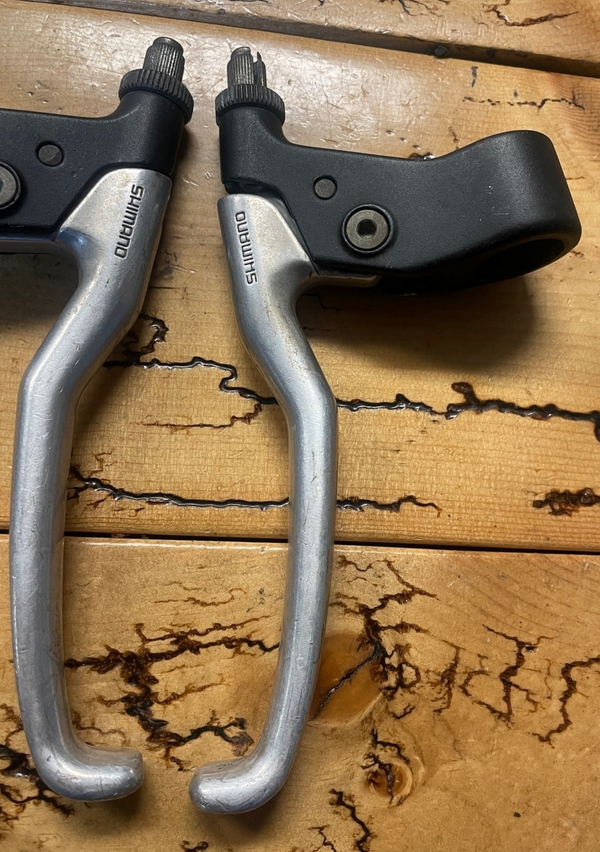

But how about some short cablepull brake levers? That would probably make more difference🤞
Looks like you've got V- brake levers fitted- they pull more cable, to suit a direct pull brake.
Prior to Vbrakes, caliper or cantilever brakes expected less cable pull.
if you you use a v- brake lever on a caliper brake, you're pulling too much cable so you get a lot of movement and not enough leverage.

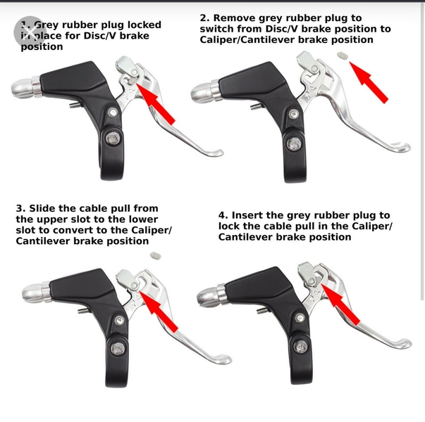

The distance from the lever pivot to the cable location is longer with vs. Screenshot_20240414-192908_Firefox.jpg
Occasionally you get levers that can do both, as they have 2 positions to put the cable head.
Youre also losing leverage due to how deep the drop is, so you're going to need lots of pull at the lever.
That's a whole lotta lever!
Giving a load of leverage, like you need!
