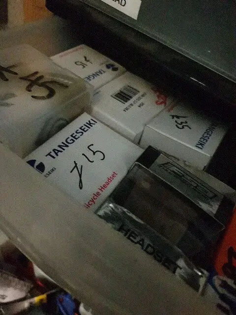

Modern tange headsetsstart at £15, and so far apart to last for ever.
You need to inspect the threads though, they might be damaged, and the loosening headset will be slowly killing them.

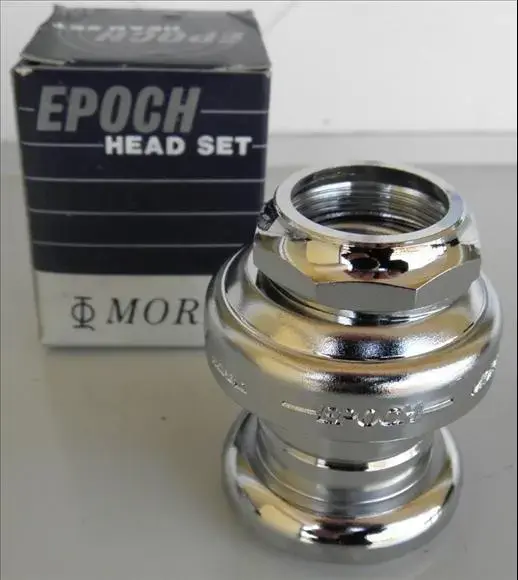

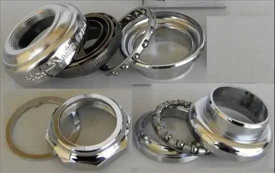

Mori Epoch self adjusting headset as fitted to Araya Muddy Fox.
