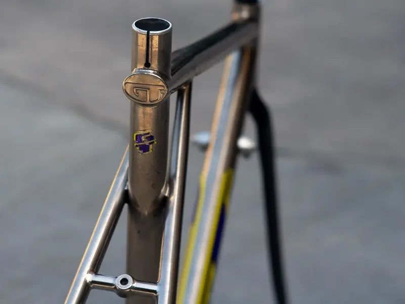

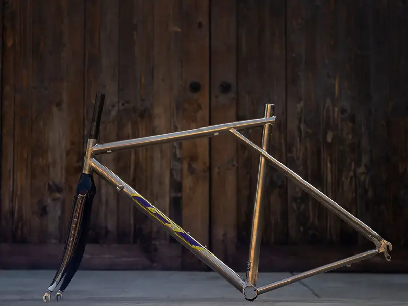

It's a 1998 GT Edge Ti, in my size. I'm ecstatic!
Geo here below from the catalog save the Seat Tube which are my measurements as they're not listed in catalog.
Frame Size 50
Seat Tube C-T - 55cm
Seat Tube C-C - 50cm
Top Tube C-C - 53cm
Head Tube - 10cm
HT Angle - 72
ST Angle - 74.5
BB Height - 271mm
Rake - 45
Chainstay - 405mm
Wheel base - 977mm
naked without the cable guides and cage bolts, the frame weighs in around 1365g ! (my digi scale was giving me 1360-1370 depending on from where I hung the bike)
I recently finished the Loa, a CX bike that I have setup to perform road duty, and decided I'd hunt a road bike project so the Loa could take full advantage of it's higher BB, longer stays, and generous tire clearance. I had a shortlist of potentials, the longshot being a Ti Edge. Low and behold some 30 days later one materialized as a frame only, in my size, reasonable ask, and relatively near. I'm pretty spent after what went into the Voodoo but I just couldn't let this one go.

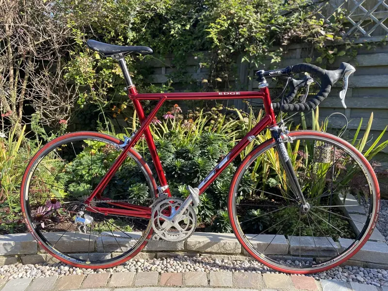

That’s going to be a great build! I loved mine but it was really too small for me at 56cm so it didn’t get ridden as much as my Alu Edge.
I never really liked the alloy/Carbon Edge forks, I’ve run both the Ti and Alu with Profile Designs straight leg. The ones you’ve chosen look a great fit.

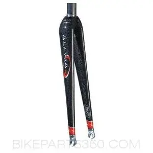

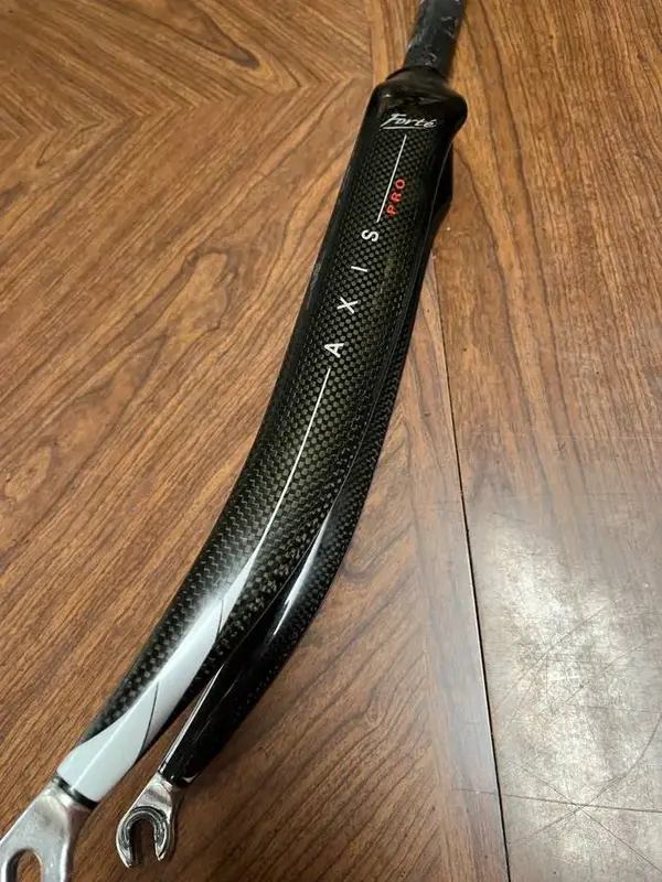

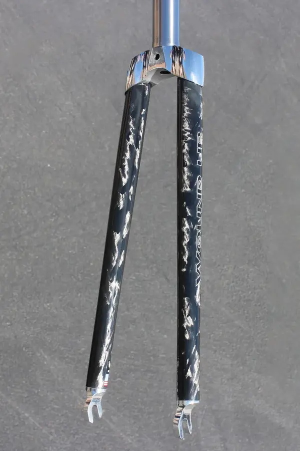

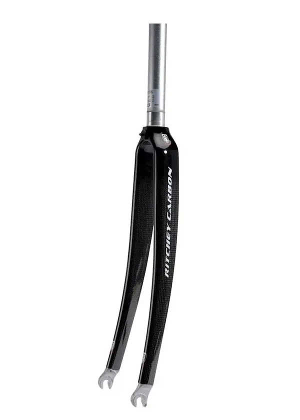

Right on ! I've been obsessing over 1" carbon forks for a few days and found quite a few options. The frame didn't come with the Edge fork but I probably would have looked to replace it if it did. I did come across the Profile Designs fork in my search too but didn't find any real feedback. The one on there now, the Forte Axis Pro, might not make the cut. I really like the silhouette but I'm not sure of the finish working with whatever else makes it on here. I did find that it is apparently the same as a Kinesis Saber but branded for performancebike.

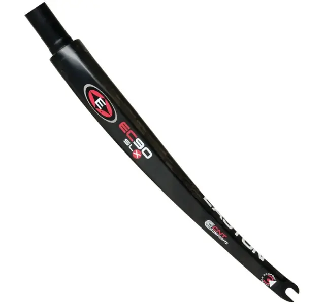

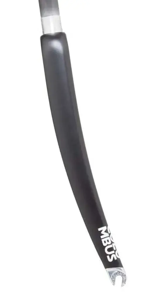

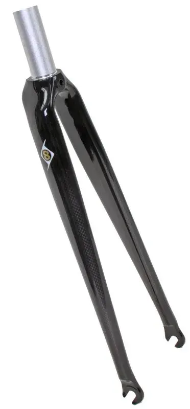

Some other 1" carbon fork options I found. Would love to fit 28's front/rear so that is a huge consideration for me. Then it's ride quality then weight and somewhere in there is look good and don't die. I need to get a hold of a 25mm OD rim and see what tire I can squeeze in the rear, any intel you can share here @Gtpulse ?
**Note the numbers here below are just found form various sources on the net. Some from vendors, some from the makers and some reported numbers collected from forums.
ForkweightbladerakeACSteerer MaterialTire Clearance
new production​
GT Edge Carbon577gcurved45mm?
Forte Axis Pro346gcurved370mmcarbon
Easton EC90 SL321gcurved43mmcarbonmaybe 28c
Wound up~600gstraightvarious368mmsteel28c
x​
Alpha Q GS10335gstraight44mm371mmcarbonmaybe 28c
Ritchey Comp Carbon450gcurved43mm370mmalloy25c
x​
Origin 8 Pro Synergy~500gstraight43mm368mmalloy28c
x​
Columbus Minimal340gcurved45mm367mmcarbon25c
x​
I know there are others but these are either currently in production or, if older production, I've found nearly pristine examples that I'd feel comfortable using save the original GT Edge fork which is here for comparison.
Off the bat, I love the silhouette of the Easton fork with curved blades (it was also offered straight.)
I know there was also a Ritchey Pro Carbon fork with a carbon steerer but can't seem to find them anymore.

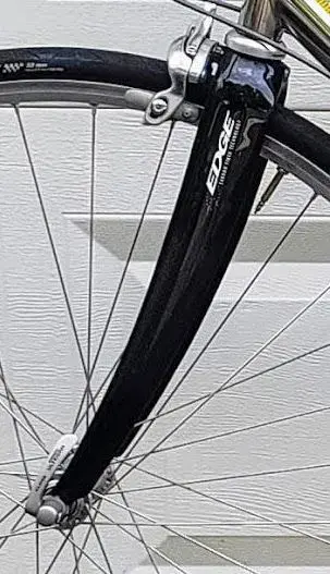

Think I ran mine with 23c tyres, never tried anything wider in either bike. You can see in the photo the 23c looks quite snug in the stays.

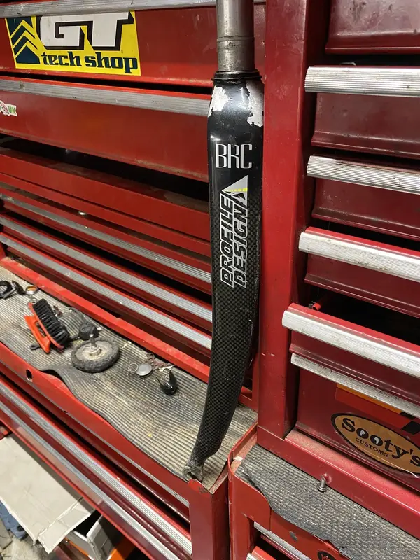

Looks like I ran my Ti with Ambrosio forks as well as Profiles. Dropped some photos below hope you don’t mind, gives you the look of each type to rule in/out if you change yours.
The Profiles I’ve had two types - the straight ones like above are something like SC and another pair I’ve got in the garage are BRC are a little more aero shaped and curved.
That does look snug. Looking at mine I am pretty sure 25's will fit and I've seen one or two instance of people running 28's but not sure if it's just a magic rim/tire combo that measures small or if some Edge's have more clearance than others? Frame size / year / material dependent?
Anyway, thank you for weighing in and for the photos, those I don't mind at all ;D Do you have a preference for any one of the forks and if so, why? I ended up getting the Easton fork as well to have the option. I'm only wondering if I should have any concern for the 43mm rake rather than the 45mm on the Forte and also that the catalog states. Not sure those 2mm will quicken the steering up too much or if it will worsen overlap. Interestingly I also found that the '95 Tech Shop catalog shows the sz 50 having a 50mm rake!
Also noted that the earlier top tube measurements are 5mm shorter and there seems to be a discrepancy re chainstay length in the 2 '98 catalogs found here in the archive. 1 is listed at 405 and the other 410.
Wow you’ve certainly done some detailed research! The most detailed I get is how long a stem I’m going to need. In terms of looks my favourite is actually the bare aluminium edge fork that came with my alu Edge, kind of reminds me of a Vitus or Alan fork. I had decided I wanted to run an aheadstem which is what made me buy the Profiles. Favourite to ride are the Profile SC, and definitely on the Alu bike not the Ti. Everything just feels spot on on that bike with those forks, comfort and handling. In my case that was probably because my Ti was a tiny bit too small for me, I ended preferring the alu Edge.
