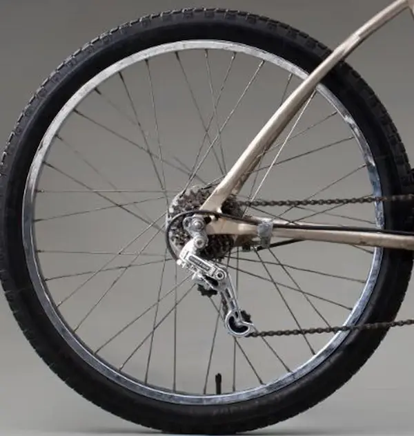

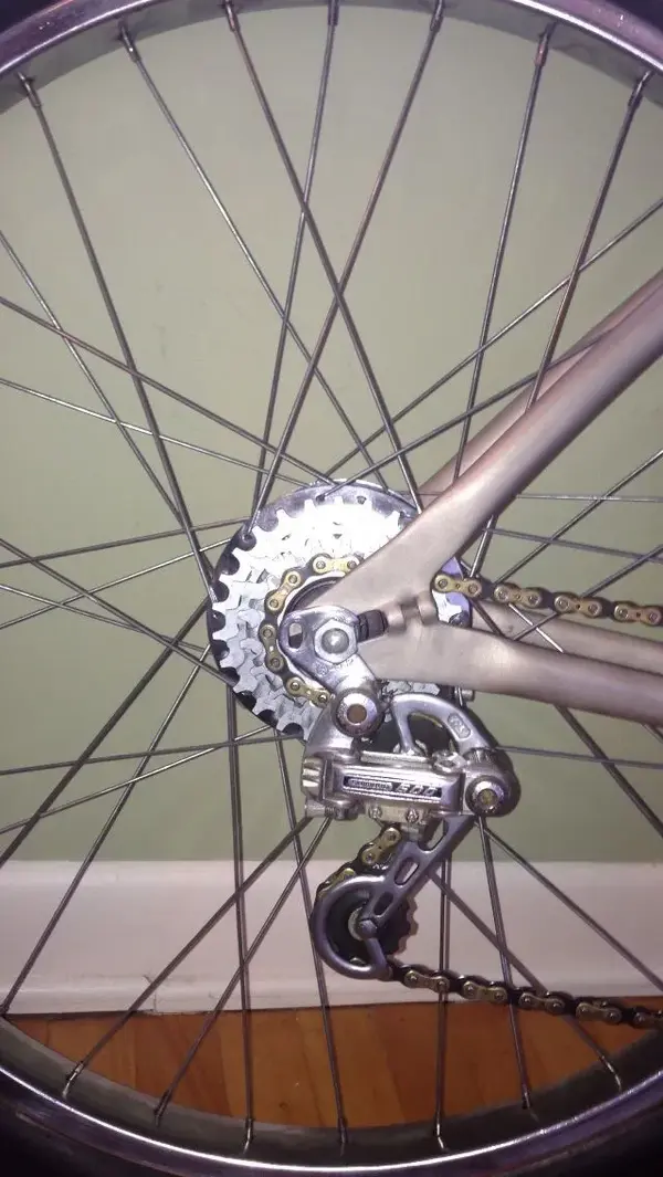

Rear wheel done. Laced with union .80 spokes the exact dame pattern as Garys..complete with "errors"..
On the home stretch!

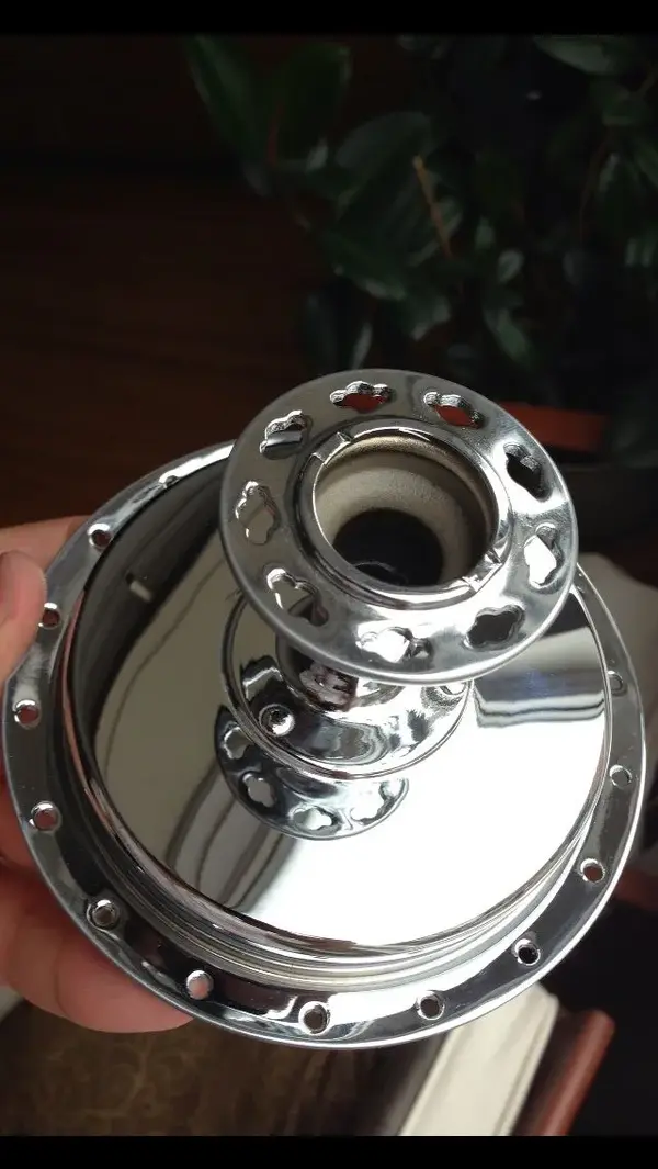

Super rare front union hub rechromed.. What a job by Gary's customs!
This will be the only rechromed part. The fork cleaned up pretty well so I'm leaving it!

curious, what are these "errors"? care to explain to the "clueless" ones like myself? ;)
Hey man,
By errors I mean that Gary's wheel is laced improperly. You should have the valve stem between the two spokes that move away from each other so it is easier to get your hand and pump in there.. I replicated this...

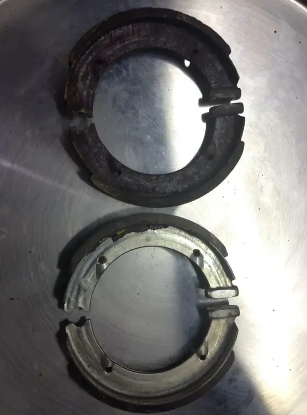

Ebay is unbelievable...60 year old NOS brake shoes for my front union hub!
