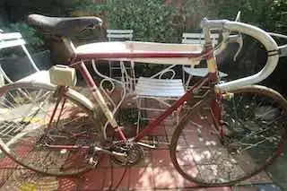

Hi Brian,
Thank you for the welcome, good to be involved.
I 1st restored the BSA in 1970, when i had all the spokes replace, frame resprayed, went to a fixed wheel and replaced the white mudguards with small alloy ones, which means i do not have any info on the decals. Your red in the pictures looks slightly metallic and brighter than mine. (picture above)
I was planning to get all the metal re-chromed, frame respray and look for the missing parts, do you still have the decal info you could share. Then I need the rear gear change, white pump and i seem to remember rat-trap peddles??
Looking at what you did it seems a similar path, would you make any changes??
Best Regards
Pete

Hi Bruce & forum,
Do you know what the original colour of the red is on the frame and forks, been through loads of web site and cannot find it!

Hi Pete,
Sorry, I missed your posts, I have been away on holiday.
The first catalogue (see page 1 of the thread) states the available colours as flamboyant red, blue, green or amaranthe (purple). I think that "flamboyant " is made up of a translucent colour ( i.e. lots of lacquer in it) over a silver base coat. I have never seen a green ToB but I have some photos of blue and amaranthe ones. Most good frame finishers offer flamboyant paint as an option.
I have got my homemade decals for the seat tube band, but I never made any for the downtube, although I have some partial artwork which I plan to finish when I restore my other ToB bike. Next project though is my 1950's Woodrup.
Hi Bruce,
I hope you had a good break! Thanks for the info around the colour, I will go for the "flamboyant red" but when you search for that you are opening a very big subject, lots of forums, any everyone has their own idea, so i guess i will have to choose. Seems BSA used the same colour on their motorbikes as well. I fear i am going to struggle on 2 points, the decals and the gears. I have managed to get a couple of of ebay but they seem quite rare. if you have any digital file you could share that would be great. The gears are also confusing because when you search Cyclo Benelux - "suicide" rod type front changer, and Benelux sport rear derailleur, there is a lot out there but not always showing the chain size ( or saying it will work on the 5 speed and 4 speed gears?) and the both costing £100 plus, i wish i had not taken them off in the 70's!
