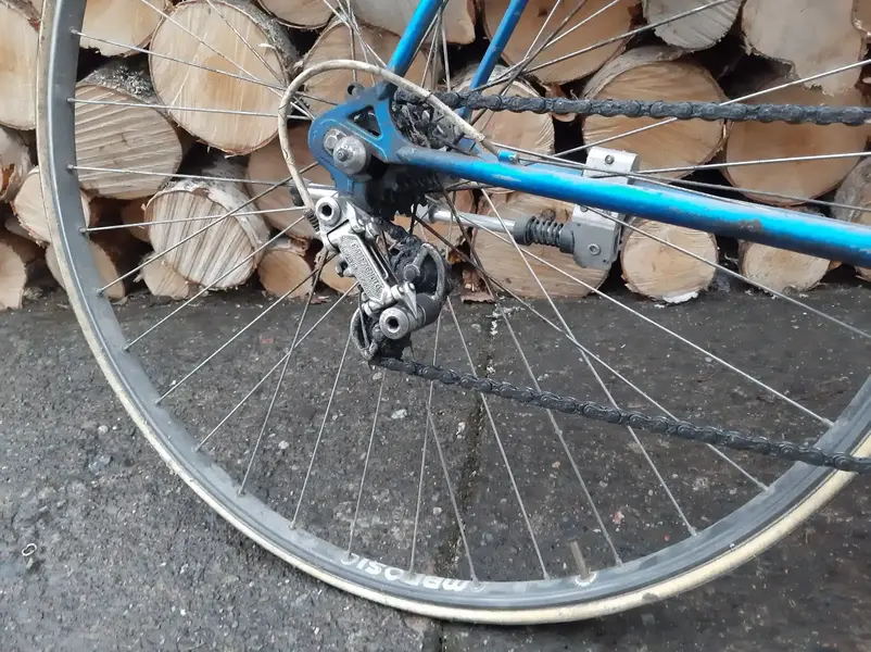

Metric tubing, weight 2200g at 54c-c(didn't check)? Seat post 26.2mm
Serial on bb, "78 O 045210"
Stamped? dropouts with hanger and "grid pattern" on the thick part around the mouth. Simplex?
Brake bridge is reinforced with "ears" and made of sheet metal rolled into a tube and brazed like on Lejeune/Carre frames
Lugs look like bocama competition 78, but I think are not those. Fork crown with flat top.
Threads are at bb BSA and headset ITA. No slot for lock ring but filed flat on the steerer tube i.e. french
Repainted, original color was silver/grey
Campy bb and hs top/lock nut is also campy the rest of hs is not
Drivetrain is campy Nuovo Record(rd & fd 78, cranks 68-72). Brakes are weinmann 605. Cockpit is SR, 22.2mm
I'd say Gitane or Peugeot
