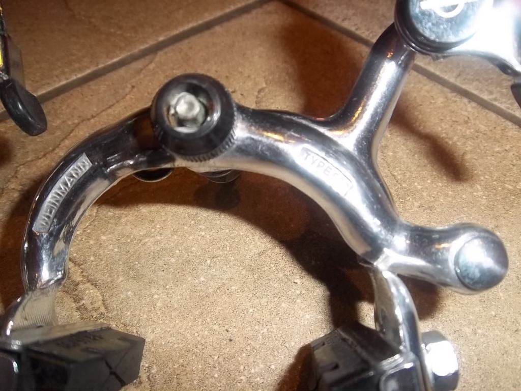

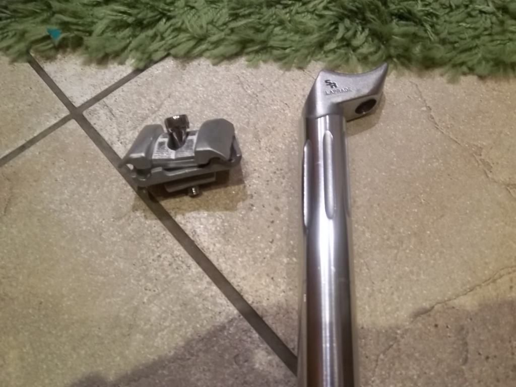

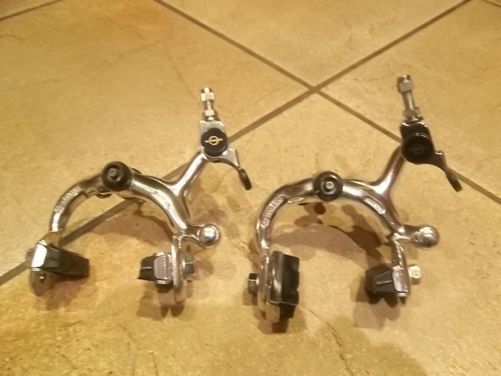

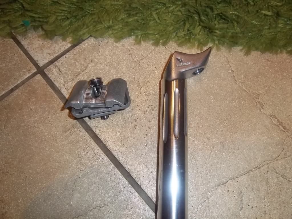

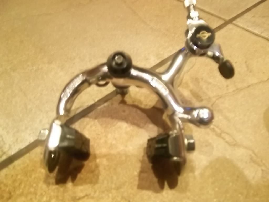

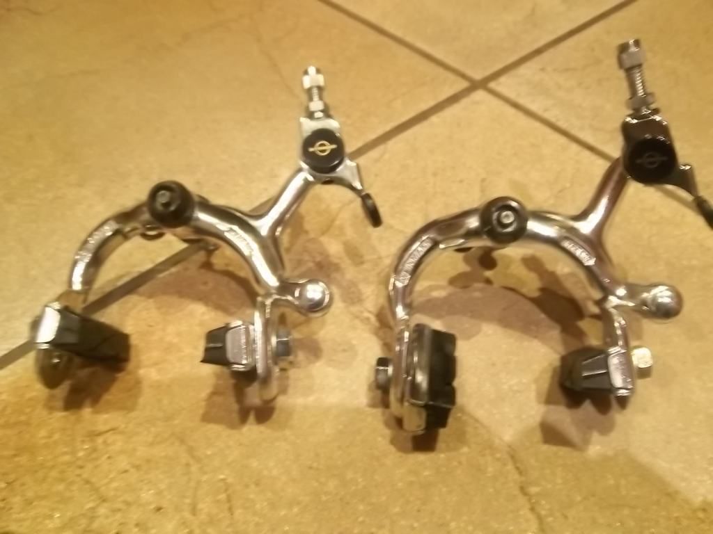

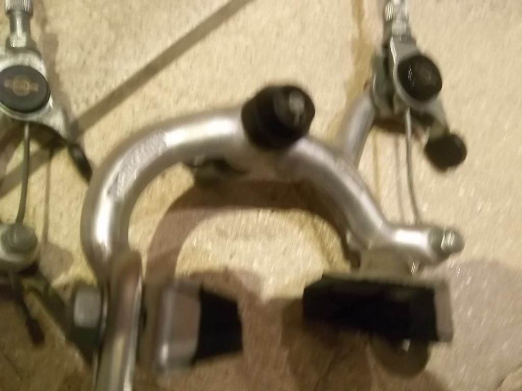

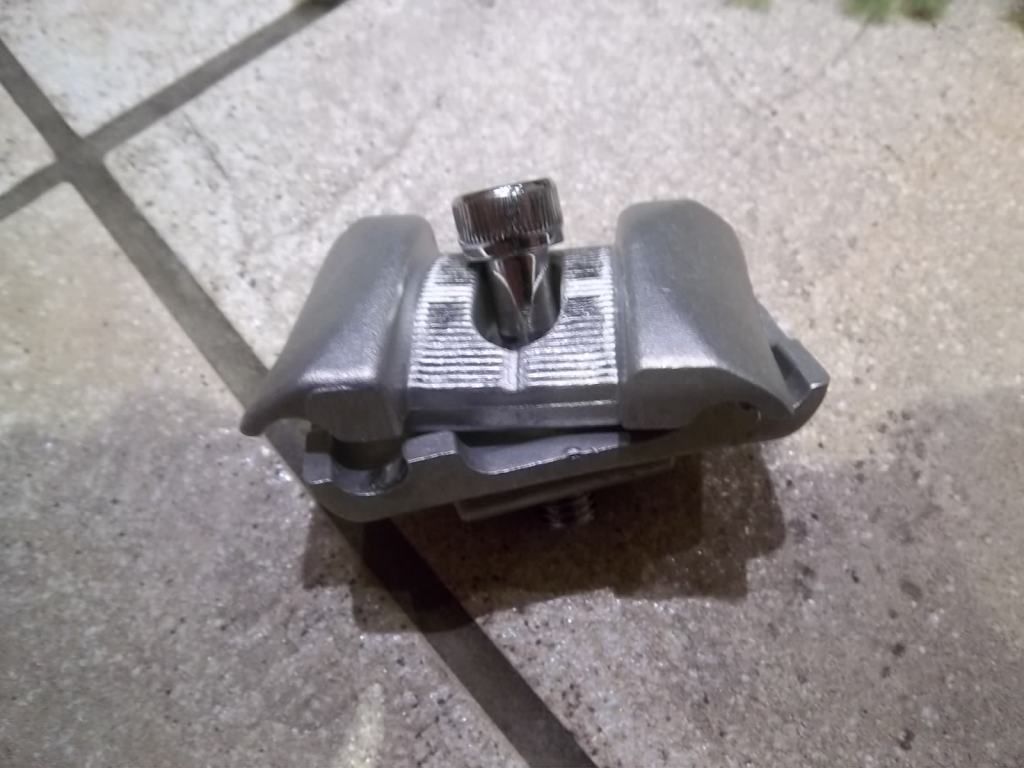

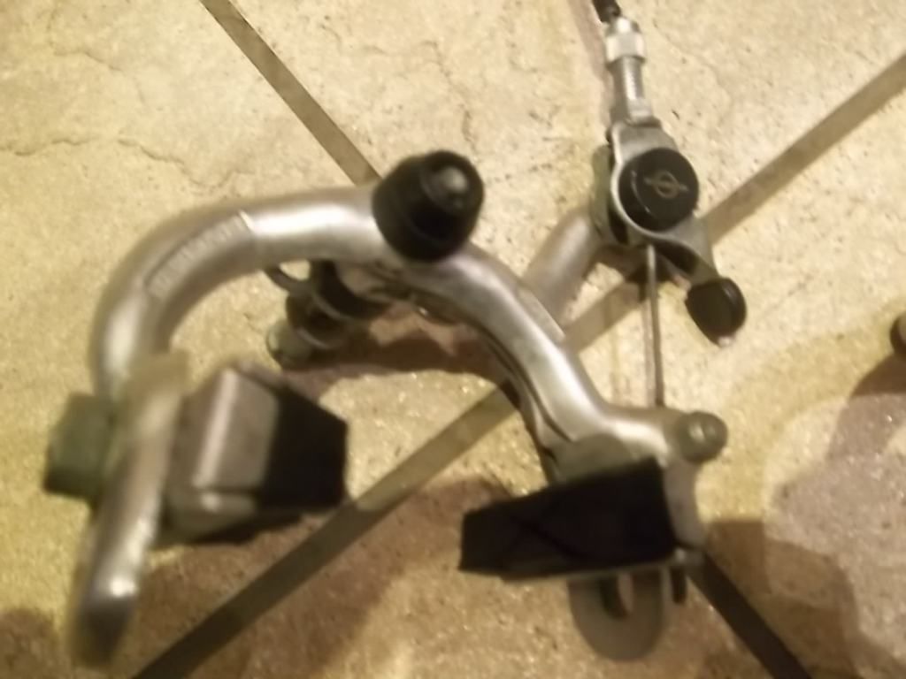

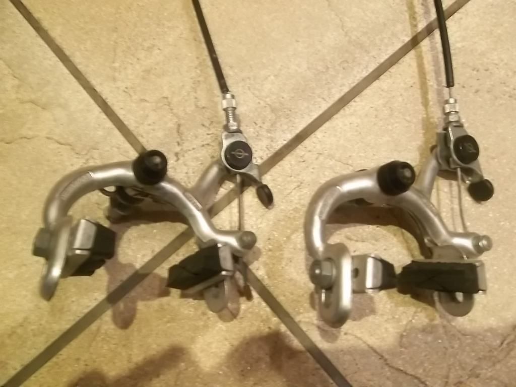

Anyways - more pics while the computer is working - not for long! These show before and after of the seat post and brake calipers - even the pics do not do them justice!

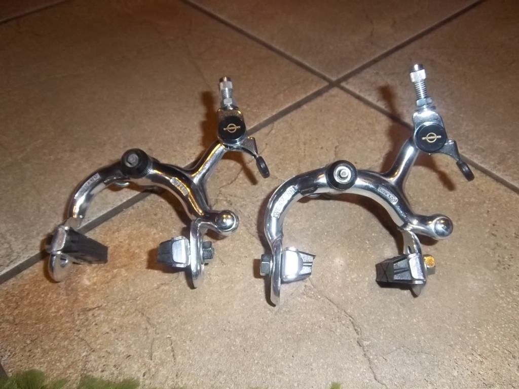

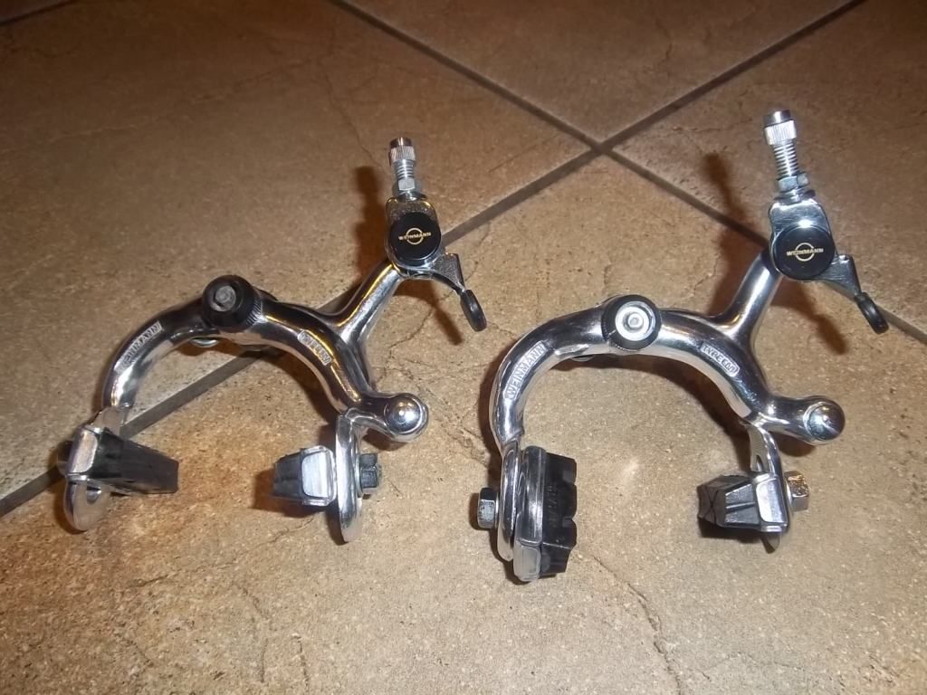

And now - TAAA DAAAAAAAAA - the polished brake calipers - sunglasses please!!!
Thanks for looking, the calipers really look better in real life than in the pics!

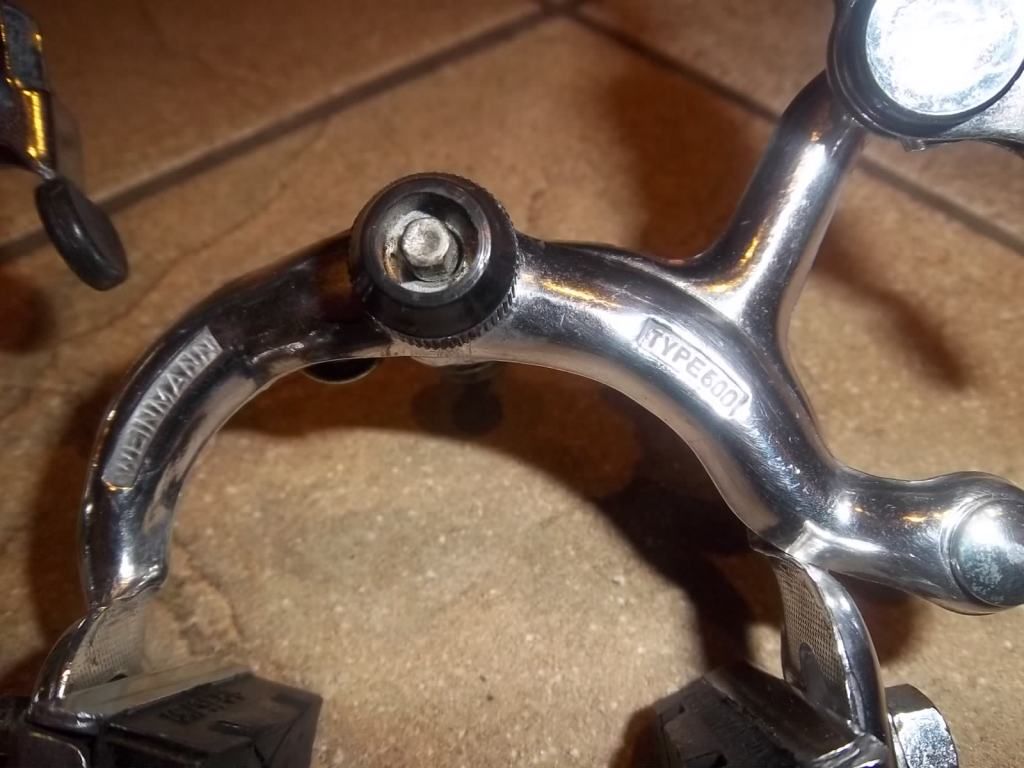

3. The main problem, side pull brakes are not that good, polished or not! Hence my change to 600AX but I still need to tinker with the Weinmanns to get them right.

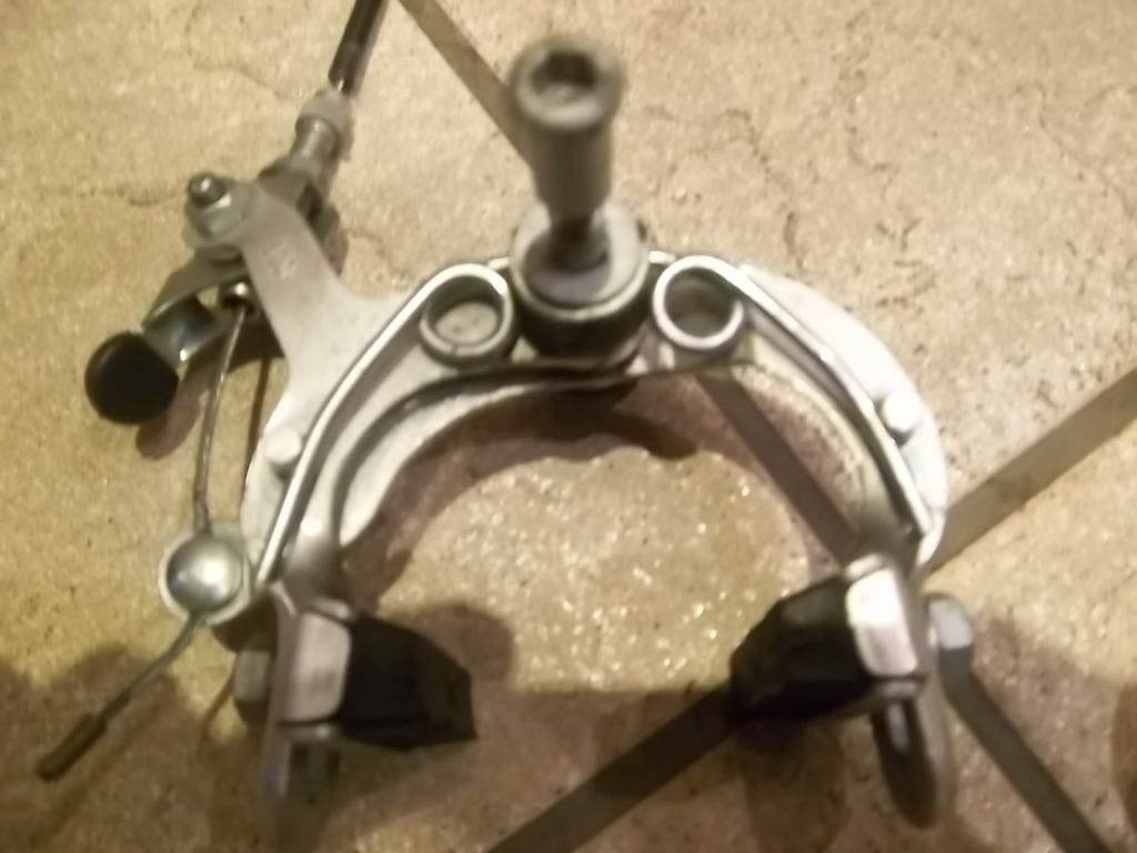

4. This is odd, the hole in the frame for the rear brake calliper Allen bolt was too small, I had to drill it to enlarge it. I cannot understand that at all but it is sorted.

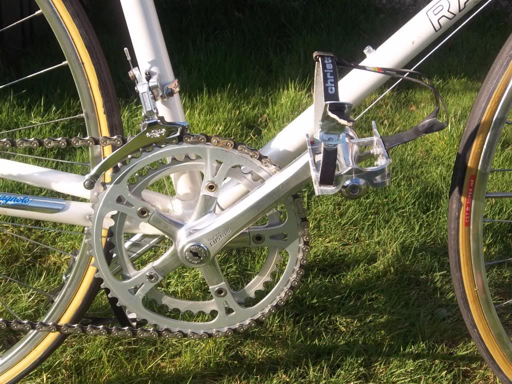

Here are a few pics of the current road-going Rapide - if anyone spots anything which should be changed please tell me - apart from those previously mentioned.

Actually Ian, those are the old crank covers, the new ones actually LOOK much nicer - thanks again!! LOL
