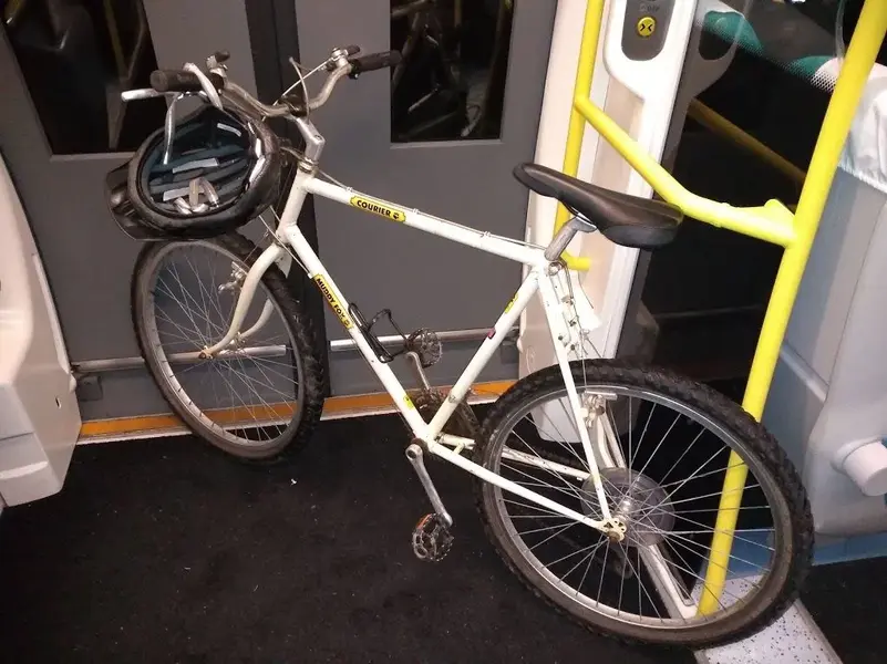

Here's my Muddy Fox Courier which I picked up a month ago. It's my only bike (tiny london flat doesn't permit building up a collection) so I'm using it for my towpath commute as well as longer rides round Epping Forest and eventually some camping trips once the weather gets better!
I bought it to replace my (very sensible, very frumpy, very un-retro) specialized sirrus which got nicked, decided to get a less 'nickable' bike and also learn how to fix up bikes in the process. I've been slowly fixing it up with the help of the lovely people at London Bike Kitchen. All cables replaced, hubs and BB serviced, new chain and cassette, panaracer pasela tyres, and a wald 139 (I think) basket and matching Restrap bag 8) oh and a charity shop saddlebag
I think it's a 1986 based on other courier threads on this forum. It doesn't have the paw print by the seatpost clamp which is the only way I've been able to tell it apart from the 1987 model.
I'm really pleased with this bike, it's been so satisfying learning how to replace parts and service my own bike, and it rides beautifully now - really fun on the more gravelly sections of towpath! I don't think I'll do much more to it beyond general maintenance but I'd be interested to hear thoughts on any recommended upgrades? A few things things I'm considering are replacing the brakes with something easier to set up and adjust - I think I read on here that Dia Compe 986/987s might be good for that? Also I'm keeping an eye out for some mid-rise BMX bars or something along those Klunker-y lines, I like the look of the Nitto bullmoose bars as well.
I'm also thinking of replacing the wheels and taking the opportunity to fit a dynamo system, any recommendations welcome. Not sure if I'm confident enough in my bike mechanic abilities to build up my own wheels yet but it does sound fun. I saw Decathlon do a dynamo front wheel for £30 - too good to be true? seems way too cheap to me but I know they sometimes do some very decent bargains.
Here's what she looked like when I picked her up in the middle of storm Ciara last month (I miss those tractor tyres but they were completely f*cked!):

Welcome to the forum. Lovely bike and much much classier than a sirrus.
It's always satisfying learning how to maintain your own bike, will help build confidence in what you are riding and bond with it.
As far as upgrades, I really wouldn't do much, these are very robust bikes so can be left alone if you wish.
I would persevere with the brakes, there is nothing wrong with canti's as long as they are set up properly and once you have your head around mechanical advantage it's pretty simple to keep on top of them. If you want more power then invest in some koolstop salmon pads; wide angle cantis like yours with salmon pads will be more powerful than most v brake setups and certainly more so than narrow angle cantis.
Also, drive side pictures are where it's at :wink:
