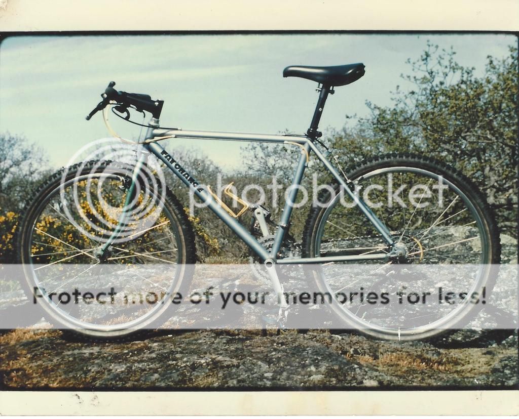

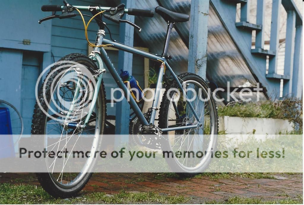

For all you stat lovers:
weight of frame and fork: 6.5 lb
head angle: 71 deg
seat angle: 74 deg
seat tube: 18.5"
top tube: 23" (23.5" effective)
chain stay: 16.5"
head tube: 7" (!)
b.b. height: 12"
wheelbase: 42.5"
One of the main inovations of the early Manitous was the wide dropout spacing (115mm front, 145mm rear), custom hubs and asymmetrical rear triangle:
It was a stretch for me to afford the frame to begin with, so I opted for standard spacing (100/130), which would save money on the build, and allow me to use my existing wheels. Crazy to think of now, as it really wasn't that much more money to add his signature innovation, but back then it was a difference maker. Perhaps that makes this Manitou even more unique?

Great story. Would love to see a pic of the Team Comp too if you have any, shame it got stolen.

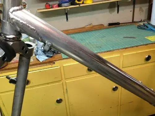

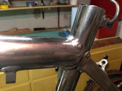

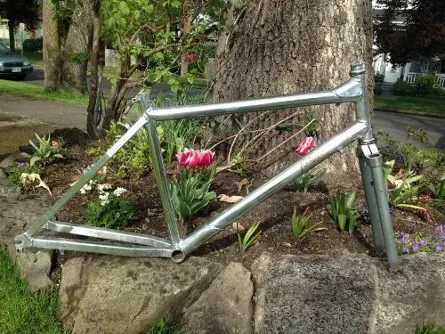

Nevr Dull is amazing stuff. I've spent hours polishing her back to life, but the results are worth it.
Getting there...

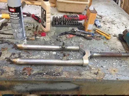

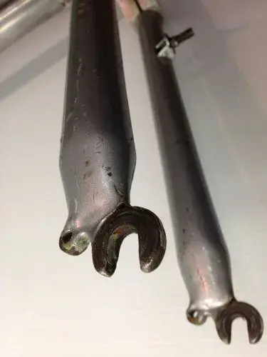

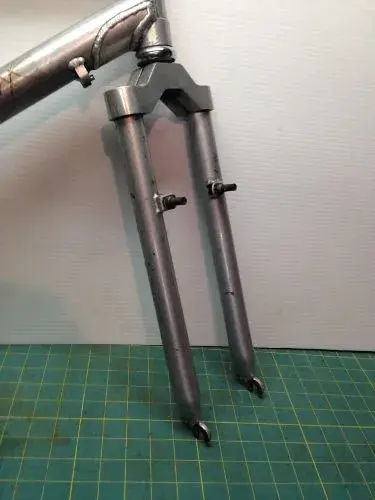

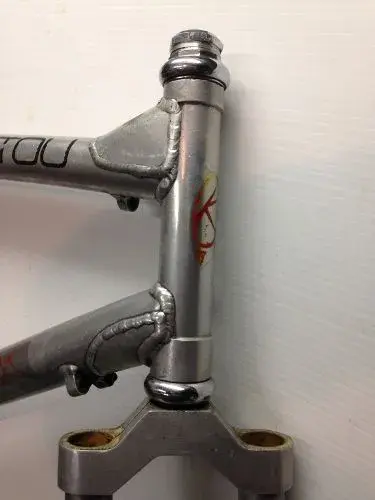

The Bradbury forks are so killer, but unfortunately when I got them back the paint was badly scratched up.
The fork crown originally had steel caps covering the legs, no idea where those got to...

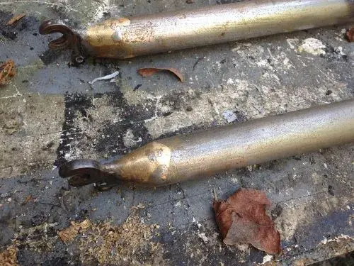

I had read somewhere that Doug Bradbury spray painted his forks himself, so I figured I could do the same (though I hate the idea of removing Doug's handiwork). A friend of mine stripped the legs down to bare steel. The brazing work around the dropouts is hardcore, he put so much time into each set of these forks!

This is fantastic industrial chic!

Thats one way to describe those welds :lol:
That said they more than did the job and TBH Dougs earlier work has stood the test of time far better than the light weight verson(s) that were being knocked out when Answer came on the scene,
