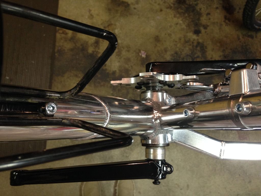

I've been really excited to put a pair of Bullseye cranks on this bike, but when cleaning and prepping I discovered that the bottom bracket bearings are shot to hell, so much play its unbelievable! I don't know how the previous owner even used them to the state they are in. So, back to the drawing board. These cranks are not compatible with anything else that I know of, and it seems that Bullseye no longer exists(?), though some people seem to have access to NOS. I have seen Desperado Cycles makes a shim that allows you to use an external cup (Dura-Ace, Phil Wood) b.b., but I'm not sure about going that route. Might have to go with another crankset for now (boring!)...

Have your machinist friend skim .2mm off the axle of the bullseyes. That will take it down to 22mm which will then allow you to use all manner of vintage looking 22mm Euro BMX bottom brackets:

Thanks Pete! I had read about that, it just seemed a bit dodgy. But if you have had success with it, I may go that route. Is that a picture of your cranks? Did you repaint them yourself?

It's as safe as houses. I have it on two of my sets:
A number of people use it, especially when there isn't room to use external BBs or with push fit bearings (like the Pace above).
I currently have 6 or so sets of bullseyes, 2 with the 22mm axle, 3 with the shimmed external bb and one with the original (and, frankly shit, original bearings). I've even got a set on my 'modern' bike:
I always have bullseyes powdercoated as its the only paint that's strong enough to last (the only exception is the Pace, above). My local industrial estate has a powdercoated who does them for me for £5 a set when they are doing a black paint day

Okay thanks for that info! I'll have a talk with him and see what he can do. I have repainted my cranks with POR15, a self-levelling rust paint that's supposed to be pretty durable, we'll see how it holds up.

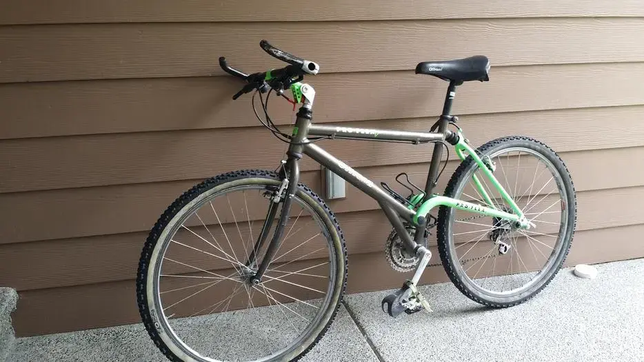

Funny too, looking at your pics, I just picked up a 1990 Pro-Flex 950 for parts for the Manitou build, looks just like yours (okay nothing like yours with the work you have put into it) but grey w green rear triangle. Elastomers are shot of course, but everything on it is original as far as I can tell. Not sure what to do with it, what have I gotten myself in to???

It's a slippery slope! Stay the course on the Manitou then do the Offroad.
