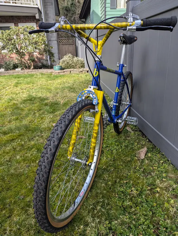

Nice meeting you the other day Roy (Cannondale M1000 purchase), I'm caught up on this thread and wow! Can't wait to see the non-teaser complete bike photos ;)
my how time flies, it has been just short or 11 years since i picked this one up.

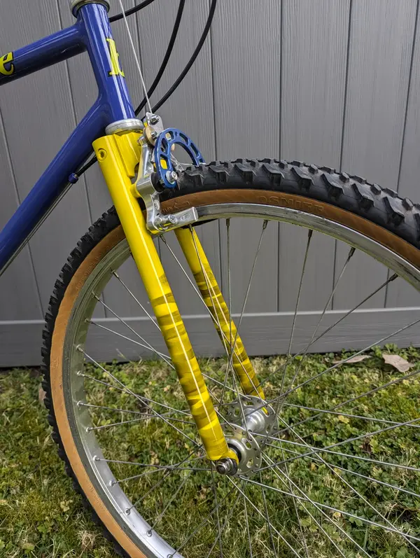

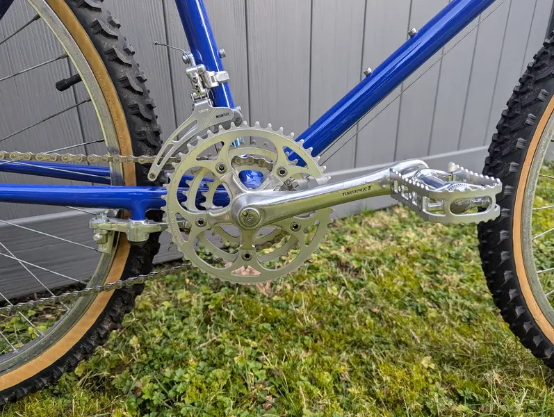

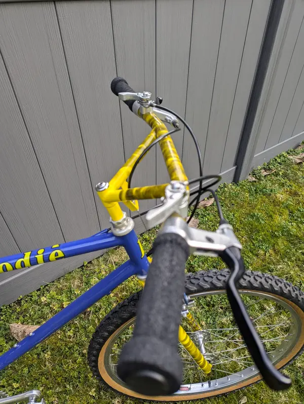

but it is finally done. the build is a bit non traditional for a brodie. i like how it has turned out.
thanks to vintageman for all his help on setup. the rollercam brakes on the gatorblade were
an absolute curse to adjust. when paul puts u brake bosses on a gatorblade he mounts them
at a 10 degree angle (i think that is what he told me) so that with a u brake the cable comes
down parallel to the headtube. this is the look he prefers. but, and this is a big but we discovered,
when using a rollercam brake system this makes for clearance issues to access the pad bolts. i tried
shimming out the arms but then they would bind when tightened down. lots of trial and error but
finally got it done.
looking forward to a maiden voyage on it soon.

Been waiting for ages to see this Roy. Love the smoke finish and colour scheme. Let's see some more of it 8)
Holy smokes! Love the paint Roy. Fascinating insight regarding the angled bosses. Great job 👏 👍
