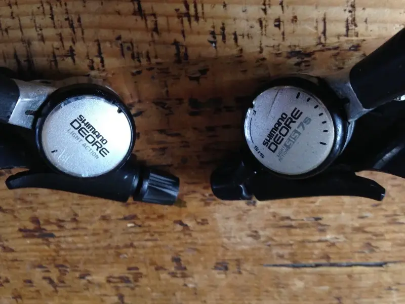

Would also you have the stickers for Shimano Deore DX 7 speed thumbshifters, by any chance?

I finished that project a few years ago, didn't bother with the shifter graphics.

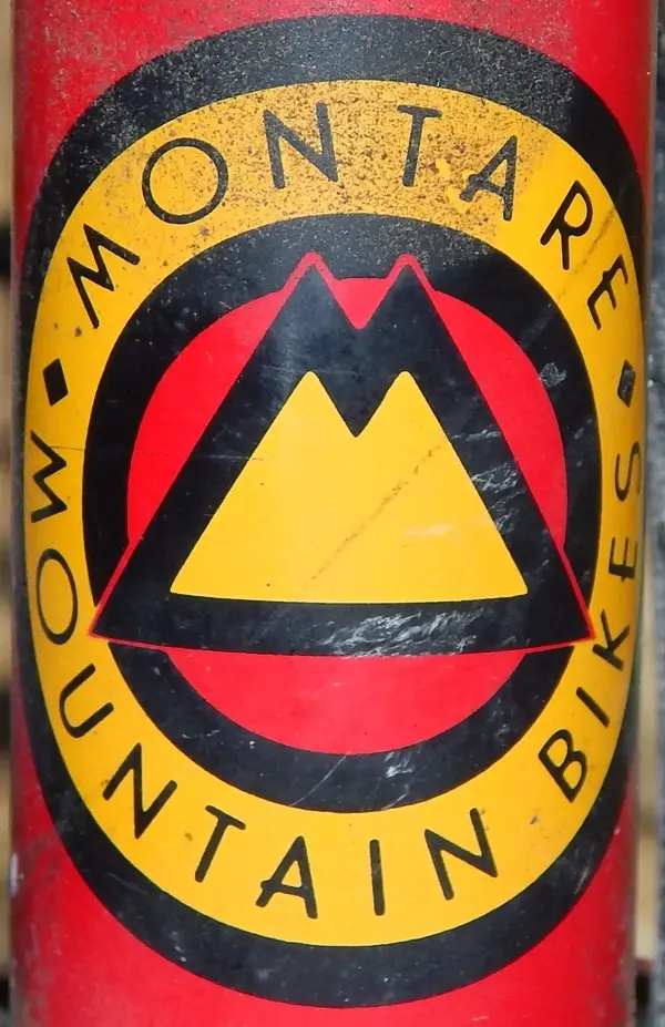

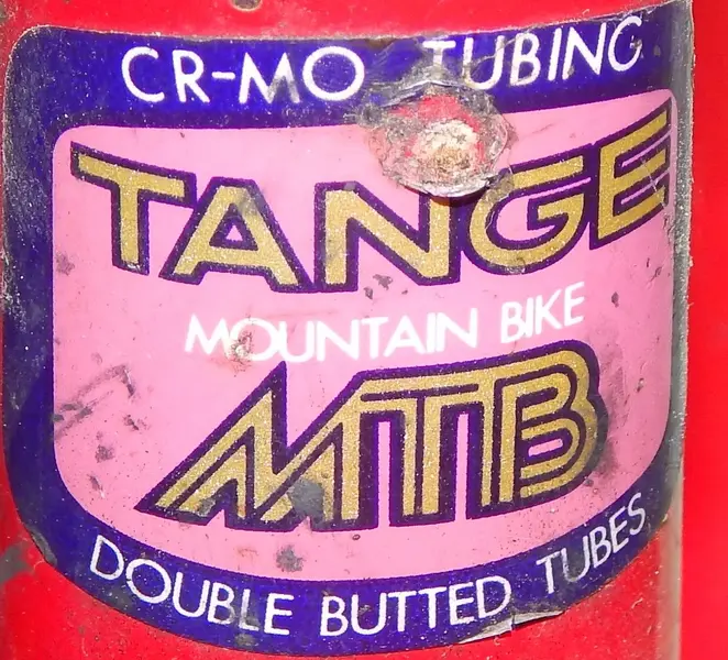

The bike I have been given is red and red it shall be! It will not be up to the standard that your restoration is however, yours looks great.. Regards to decals I have seen some Fisher decals that aren't for this bike but its the easy option (and cheapest). I don't want to throw cash at the project but its a bit of history that I would like to preserve. Thanks for the reply:-)
Your decals are a different style to the ones I recreated, I don't think you can find them for sale anywhere either.

Those stickers look mostly intact.
Before you remove them and strip the paint, it might be a good idea to tape some tracing paper over the graphics and trace them as neatly as you can.
Once you have accurate outlines, they can be scanned and along with photos of the graphics (maybe taken from side on and several other angles to take into account tube distortion). Any sticker specialist will be able to reproduce them accurately in Adobe Illustrator and print/cut them out in self adhesive vinyl with the information you provide.
The most challenging part of reproducing stickers is to get the dimensions accurate - what I ended up with is pretty accurate, the downtube sticker is slightly off though.
