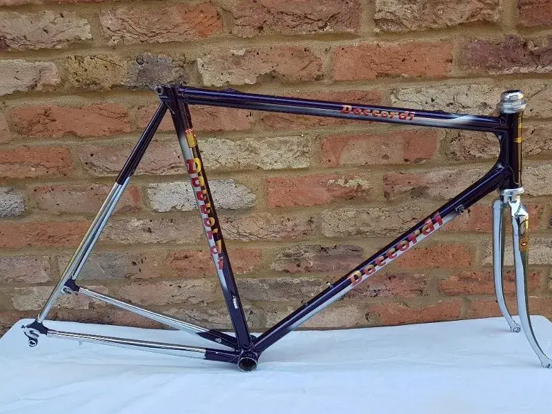

I have recently bought an original Griffe from the early 90s. Yet to build it up but it looks great as just frame and forks.
Man, those griffes are great!
i believe they are essentially the same bike as the one i have, though the later models (like yours) do seem to have a slightly different lugs on the head-tube, ironically without the distinctive Griffe claw pattern :lol:

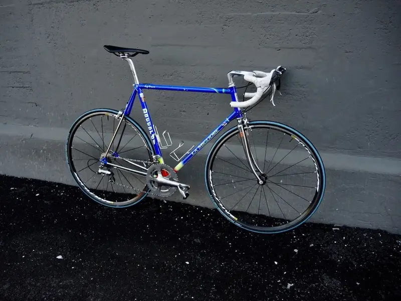

And have cold-set (aka bent) the frame for 9 speed hub - daunting but entirely doable following Sheldon Browns expert posts on his website
Thats a nice daccordi you got there - from the 80s i presume?
on a lot of daccrodi models, the model name is written on the seatstay, and it looks like yours have that too.
since mine is a 90s model, it came with 130mm spacing from the factory, so no need to cold set luckily.
that aside, i changed the Deda piega handlebar for a nitto m106, as i couldn't get a nice transition from the tops to the hoods with the piega.
no matter how high you placed the hoods, you would always end up with a dip that put a lot of pressure on the back of the hands.
i haven't had the chance to dial the angle in perfectly yet, but so far the transition seems to be a bit smoother with the m106.
you can see what i mean with the annoying bend on this picture with some r2000 levers mounted.
the dip isn't that much of a problem with longer modern hoods like on the r2000's but with the 7800's you ended up with your palm on top of the dip, making it really uncomfortable.

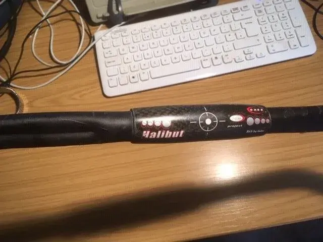

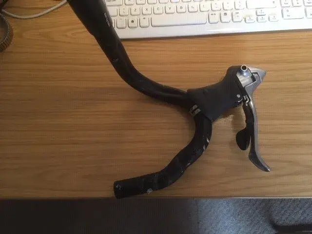

Looks good - I have an old set of defunked bars by GASS that had a habit of alloy disconnecting from the carbon midsection - now bars are all carbon - these are 20years old. But will be unlikely to loose both bars at once - and having had the stem break on me anything else seems trivial.
Have checked the fitting as I have 105 5500 flightdeck shifters that I am adding to get rid of the downtube shifters.
Just checked out the Dura ace groupset on line - £1000 for a new set - I think I'll stick with my cheep and cheerful 105s. Will post a picture when finished - about to lacquer the frame now!
