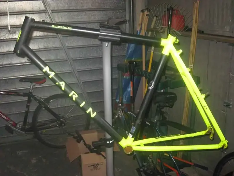

This is my first post on the forum. Inspired by some of the great piccies and discussions on here, I have decided to finally get round to doing a complete overhall of my Muirwoods.
I have attached some piccies so you can see stage one. The bike hs since been blasted and primed and is now at the paintshop for a black metallic finish before I build her back up.

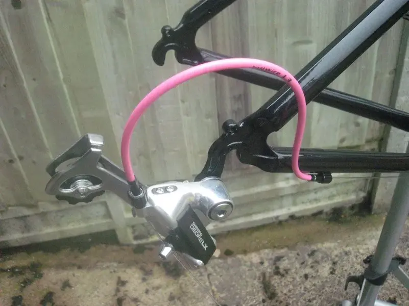

I have got a NOS biopace crank set and a new 200gs front mech. may have to recondition the 200gs rear der as have had no luck with a NOS version.

Hi Paul
Nice to seem some love for a 'low end' Marin. I have a 1994 Muirwoods which was given to me and it's great.
You'll probably struggle getting hold of 200GS stuff, but you'll be able to get hold of LX or DX mechs from the same period pretty easily.
With regards to graphics gil-m is a good person to get in touch with for some repros. Benandemu has also got them on file. If you PM either of them they may be able to sort something out. You could even get them done in pink.

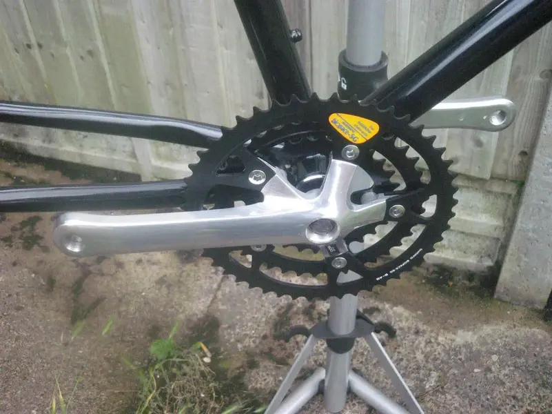

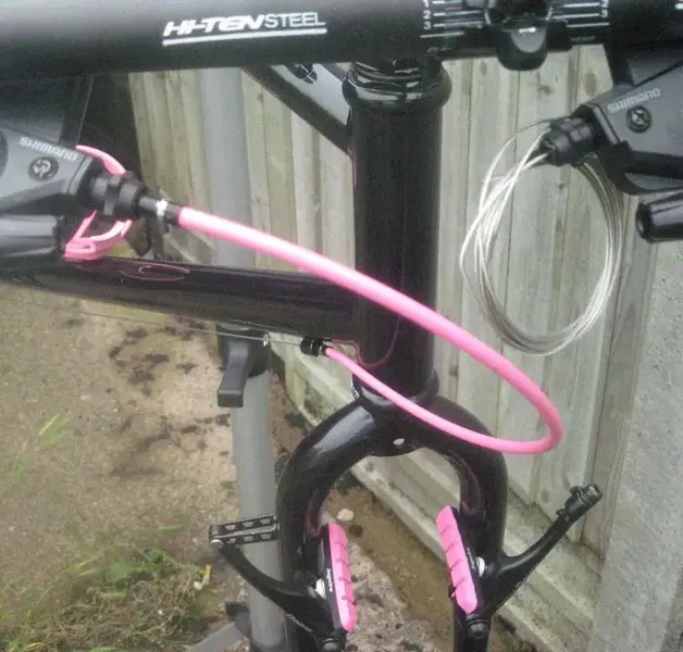

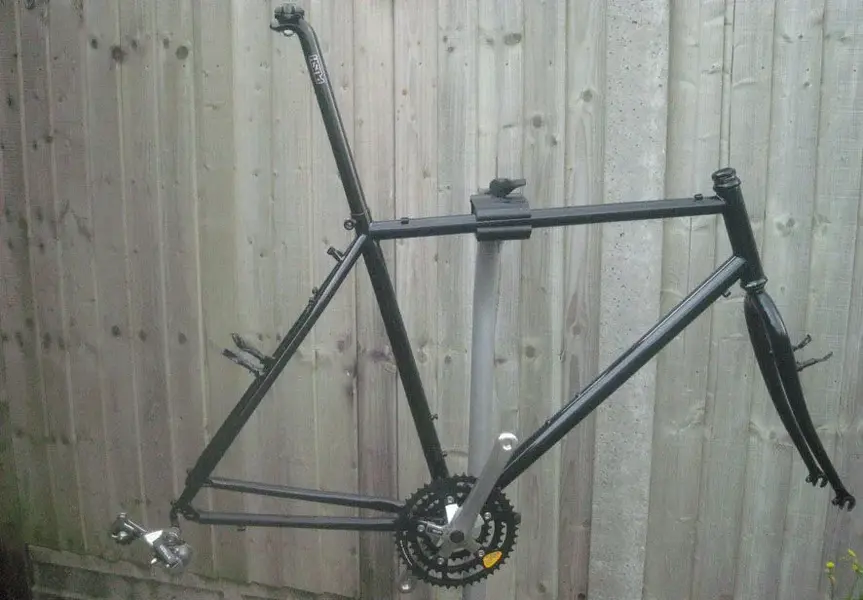

Well after a few false starts, I finally got cracking on the build today. Got the frame back on thursday from a local spray shop but there were a few bits which needed touching up. My mate has a sprayshop and he'd never done a frame before. Im really happy with the finish and the black metallic looks wicked in the sun. The BB shell had a lot of overspray so that was a big delay this morning. wire brush didnt really do the job so I had to go round the thread with a small screwdriver which was painfully slow going. With the BB fitted I made swift progress.
I have ummed and ahrrd over which way to go with the build it terms of whether to stick with period parts or modern. I have ended up with a mix.
to compliment the black I want to have a many contrasting pink parts as possible.
The stem in the picture will not be staying as i've managed to secure a nos hot pink marin one from the states which should be here soom. I will also be looking for a better quality seatpost and bars. Pedals are LX nos.
Im loving the pink Jagwire cable set that ive partially fitted and the pink brake pads too.
