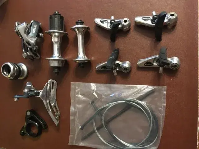

I stripped the parts off and cleaned up the shifters/levers, brakes, seatpost, bars stem and headset. Binned a few bits that were low end/knackered namely, the chain, driveside crank and grips.
I needed a rear mech, cables, driveside xtr crank, Ti saddle and seat clamp also a wheelset and some grips.

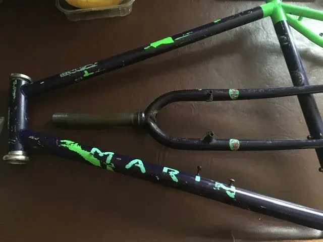

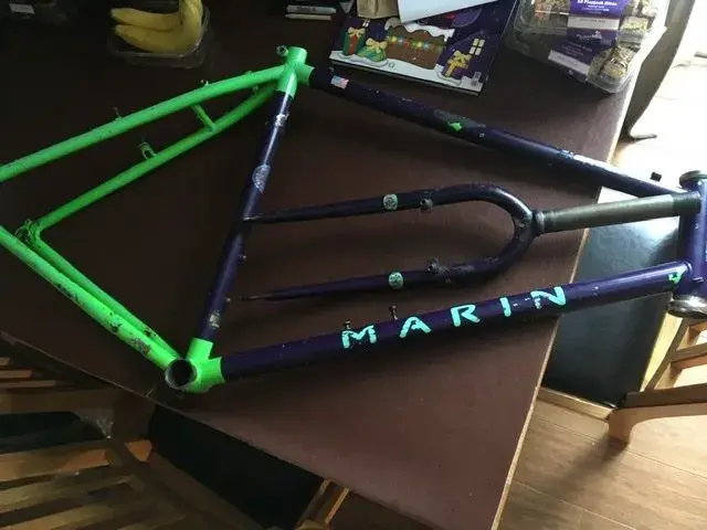

Someone I know offered to blast the frame and get it powder coated which was great. We agreed on getting the blue done and I’d look to get the green back end sprayed afterwards.
Some pictures of the frame and forks.

The bottom bracket was stuck fast. I tried just about everything to move it to no avail. Eventually I managed to malform the non drive side in a vice which broke the rust seal. Hammered the spindle out and got to work with a hacksaw on the drive side cup. It took about 2 hours but I wasn’t giving up on it.
The Frame and forks have come back from blasting And powder coating. They’ve done a a good job except its signal green and was supposed to be in a dark blue and I’d planned on using a neon green on the back end. As the original frames were painted blue over the green I see why they’ve done it.
I’ll get it stripped again and look to paint it myself or use a friend in the Motor trade if he can get the paint easily.
In a fit of depression I’ve cracked open the autosol and cleaned and polished all of the components I have.
Hubs and rear mech arrived in the post so I gave them a go as well. It’s surprising how cheap people sell stuff when they can’t be bothered to clean it first.

Im sure it was more a purple than blue though :?
