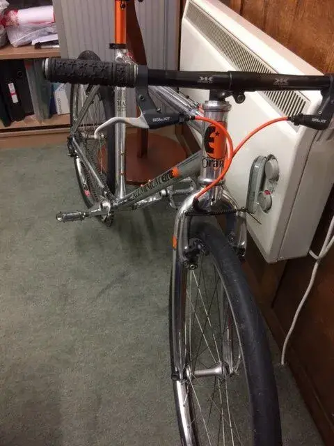

Some piccys of my new toy........

Are they XTR/Araya 395 wheel (squinting at the picture hard to make out but don't look like Araya 400), have a slight point in the middle and concave sidewalls?
I like that orange post, I think it's a new modern post.
Some good kit on there.
Are you using an iphone by any chance (upside down pictures).
What's your intent for the bike.
The XT lever (739?) and slightly newer LX V-Brakes should work well.

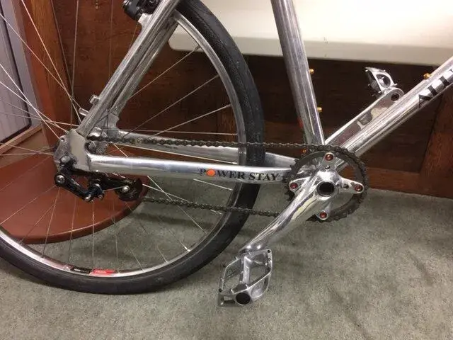

You can fit more rings to the crank, cannot make out what it is though (you can stick better pics up somewhere else and link to them if you want)
Or just buy a nice 9 speed shifter, rear mechanic and cassette.
Hi fluffychicken.
They are indeed xtr/rm395 rims, the cranks are xtr and the front chainring is a middleburn 32t.
I am about to fit a pair of Hutchinson Tioga's ('cos I like 'em).
I am thinking to go with an xt 7 speed set up, and leave the front as is. Not going to be using this in anger ( those days are gone lol), just would likea bit of help on the (gentle) climbs.
You'll need 8sp, the M900 where designed for 8 speed, though not Compact Drive so you'll be limited to a 12T smallest unless you bodge it with a 1mm spacer, though mine eventually chipped the freehub body where it screws in)
They are a top set of wheels, my favourite rims (they are the best Araya made) and better than the Mavic 231's by a long shot. It would be correct for the age too.
The XTR is M960 then, early 2000's
32 is quite low if you do a lot of road work. But see how it goes. Grab any of the SRAM/Shimano 12-32 or 12-34 depending on what you want.

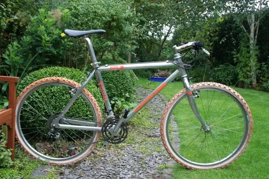

Here's mine with xc pro.

Nice bike emjay, I'm envious of your ali stalk!
