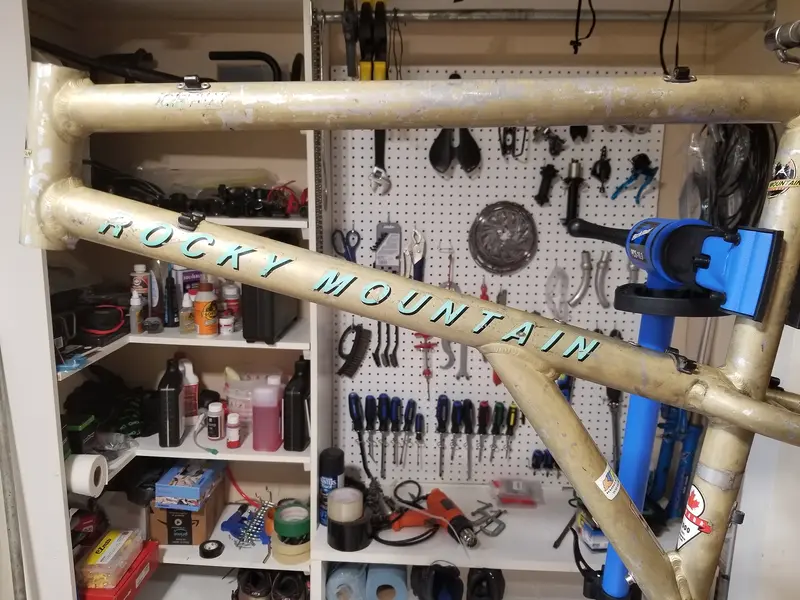

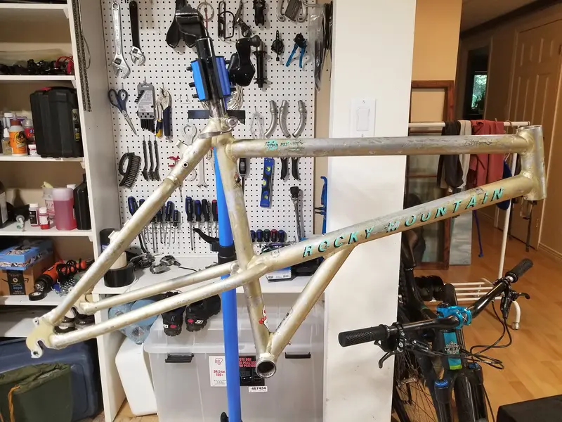

Here's the frame before coat stripping :
Stripping process. Much more arduous than I expected. Thought it would peel right off given the actual state of the coating. Not so. Not sure how it goes in other countries, but here the strong and effective (but nasty for mommy nature) paint stripper is not sold anymore. What we have availlable now is not as effective. It did work pretty well on an old Cannondale but really struggling on this one.
You've got the twin of mine, same paint and decal scheme. I used a stripper, than several grades of sandpaper, as mine looked like something from the Black Lagoon. I left if unpolished, but am thinking of having another go for a mirror finish to match my Stratos.
i'm lazy. i would have left as is. keep all the original decals.
give it a good cleaning, build it and ride it.
Nice project. I'm with @Retro_Roy - I like the patina of the discoloured lacquer and original decals, however I fully appreciate it's not for everyone and no doubt with a fresh new respray I'll be eating my own words as I say it looks amazing! 😜 🤣
Good luck with the stripping!
With @franx's bike, the paint is really yellowed, so it's a good idea to remove it. But it's really hard to replicate the standard Cirrus finish as it was raw aluminum (including tooling marks) covered with clearcoat. Anything you do to remove the paint will mess with the raw aluminum, except if you can get hold of an industrial paint stripper (or have lots of patience). Once you start sanding, you'll never get the same finish again, it will look too uniform in the end :) I was lucky that the paint on mine wasn't yellowed, it was just a bit worn, so I left it alone.
