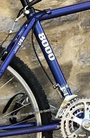

I could be wrong here, but wasn't the front mech widget needed as a converter for a bottom pull mech and top pull cable routing? Couldn't you just use a top pull mech? They are plentiful now but were allegedly the devil's work back then, hence the widget?
Problem is that there’s nowhere to stop the cable on the seat tube, outer cable arcs from top tube to the mech:
