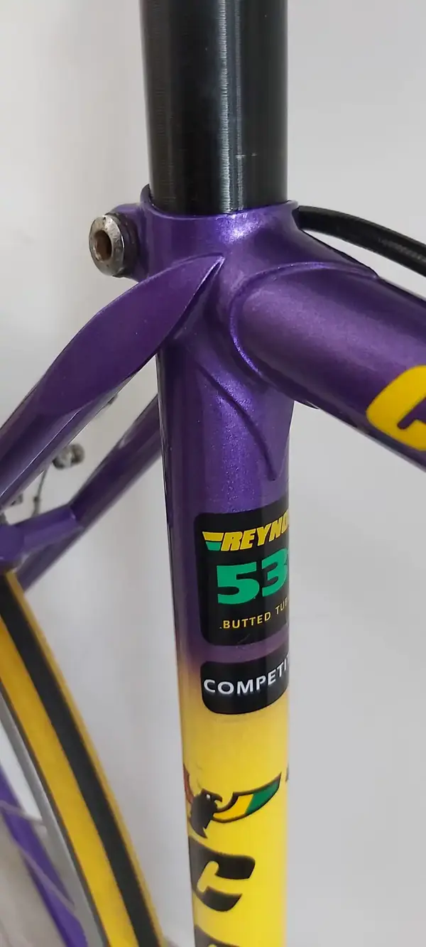

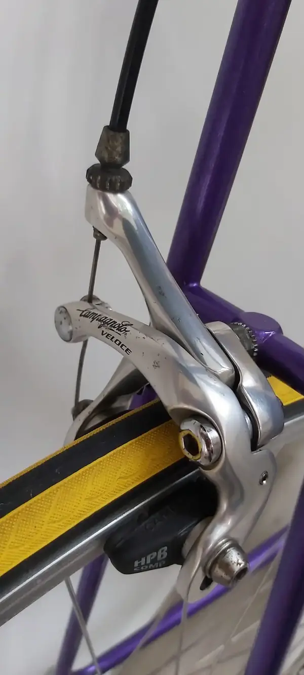

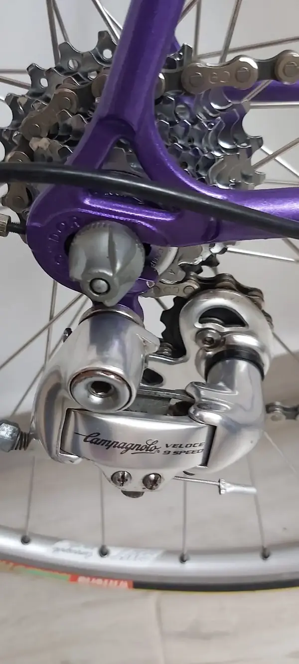

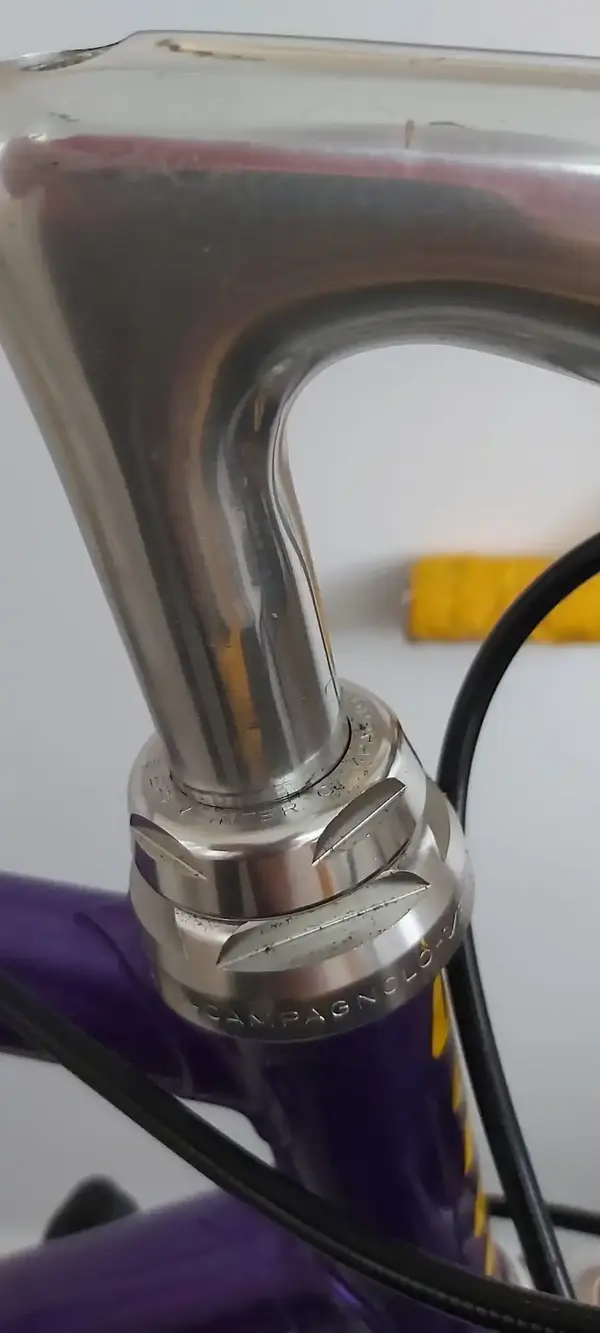

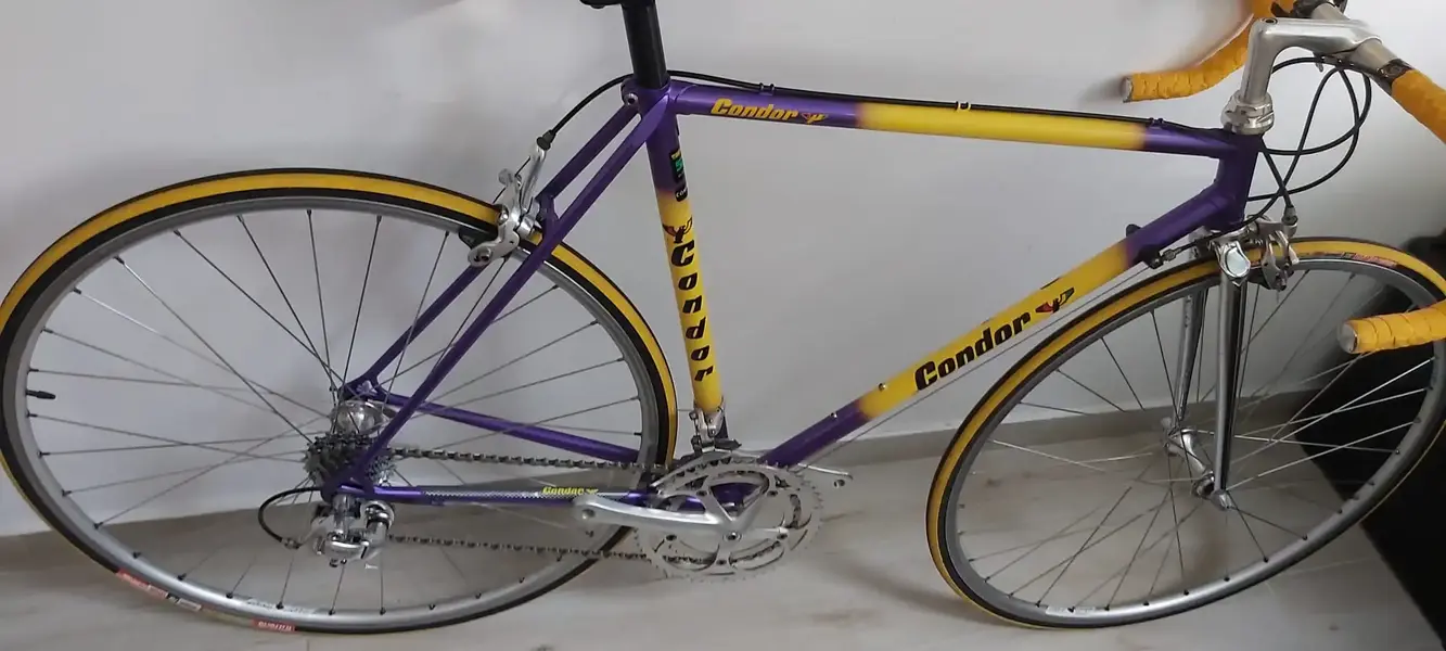

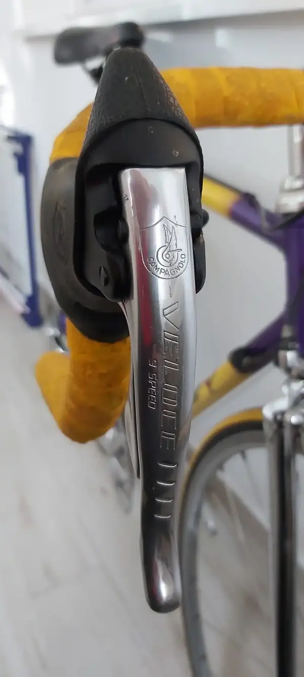

Hi ! :) Can somebody help me with this Condor bike info or if is an original model? I did not find any catalogue...Thx a lot

I'd say from the Condor branded dropouts its definitely legit, it looks a little more basic than others though (lack of pantographing, simple lugs) so it could well be one of those buit under contract by Nigel Dean for Condor. The frame number would confirm this if you can find one, it will either be 4 digits and therefore probably DY/Condor built or not, and therefore ND built.
Thanks for your answer. I ll check the serial. But it is really Reynolds 531C? Decal 531 looks new and the fork ...no decal
