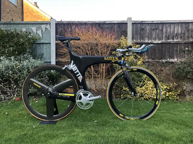

Bit of an update following the first ride this weekend!
Got invited down to Thruxton for the 10 mile TT along with some other pre-96 'bandits' to mark 25 years since their culling by the UCI.
Was slow as anything (mostly owing to a questionable training regime of booze and next to no exercise over the past year or so), but it was great to have it back out and ride my first ever TT - nice to have a time to beat now. The frame is tiny so I'm going to put some work into raising the seat over the winter, it's a good 3-4" below where I'd like it to be and was all kinds of uncomfortable to ride because of it, but still enjoyed the day.
I've put the bike back to more or less to its '94 spec now; Cinelli XA with Cinelli Tempos, 3TTT Bio Arms, a Comete sourced from France and a replica GAN graphic made up for it. Also squeezed a 23mm Corsa on the back which runs hilariously close to the stays.
Despite the general success, the bike does, however, now need a new front wheel as I drove over the Cosmic on my way out. Frustrating but at least it was the relatively easily replaced one. Important lesson learned about checking everything's in the boot before you go.
Bonus pic of me about to do my best GAN impression, don't think I'd have made the cut with my time...
With a taller seat clamp / modified post (and new front wheel!) it'll be sweet, really looking forward to getting it out more frequently and, hopefully, running a couple more TTs on it in future.
Last parts to source are a Mavic 305 headset, a Cosmic for the windy days and a 3G for the rest. For now though, just glad to have got out on it for more than a roll around the block!
