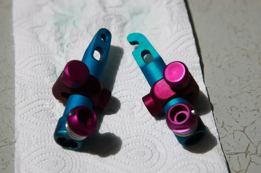

Attempt #02 with the cantilever arms. I took a rough scotch brite pad to the surface and performed a long duration polishing. Then hot soapy water clean followed by ten minute submersion in commercial degreaser. Came up with a better suspension system and etched for about ten minutes. Anodization was about an hour and ten minutes or so. 8V @ 3 amps, but this quickly dove to around 0.175 amps (which is very good). I did one piece rather than committing to two, just to see if I can get the process to work. Though, I hope I can get a close color match with the other arm as these are done separately!
15 minutes in the dye bath at around 40C, then a quick dip in the sealing bath.
Looks blue in this photo (white balance issue), but is absolutely teal in person.
First go's on the left, second go on the right:
I had to fully redo the SRP cantilever brake pillar pieces. The purple/3DV parts are complete along with one set of brakes themselves. What I thought was good in the last post began flaking off. Had to toss the prior etchant solution and make a fresh batch. So far the first set took color quite well. Also extended the etching time from about 5 minutes to 15 minutes to make absolute sure the acid eats at the surface and any remaining OEM silver anodization.
Been a fight and a half with etching, anodizing and dying. I have about 20 hours into these with all the redoing and troubleshooting.

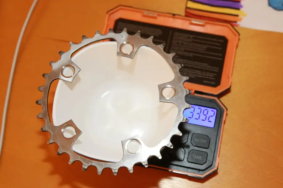

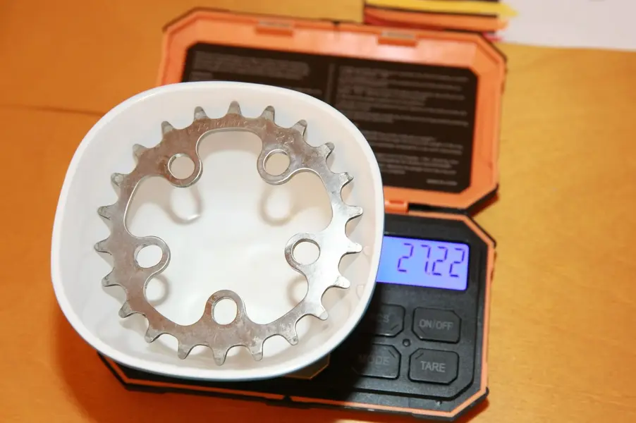

Parts update! Big THANK YOU to @RockiMtn for the chain rings and @Star12 for the reassuring vouch!
Action Tec titanium chainrings 42-32-22 compact set. That settles the crank dillema of choosing the Kooka or Grafton cranks; Kooka it is.
New weights:
42: 79.40 grams
32: 33.92 grams
22: 27.22 grams
Just waiting on the chain ring bolts to arrive and will anodize these rings. Any color suggestions or colorway suggestions? The Kooka cranks will stay predominantly teal.
