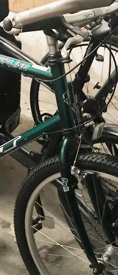

Do you have an image of the front end of the bike? This may help see what you have set up so far :)
It's being stored at a friends place in a distant town. I've not even seen it AFK, so this is as close to a picture of the front end as I can get:
