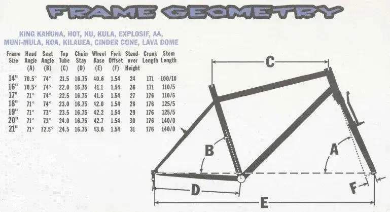

So it's a Lave Dome? same frame as a CinderCone and only change in the frame geo is the seat angle by dropping down to 18" from 19" now 74 from 73, but I assume most bikes switch this as they drop down (I know rockies did as well)
Same frame weight as the 1997 (claimed 4.5lb 18") Anthony would know better but probably just the same frame churned out and why not it worked :)

Its a size smaller than the cinder Cone so less material = lighter.
My observations about the slight differences in geometry were made 'by eye'. Could be the case that this frame was slightly out of manufacturing tolerance, or maybe the 'race light' and 'mountain shock' versions had a slightly different geo to compensate for longer suspension forks. Hopefully Anthony can clarify.
:D just comparative weight I know it'll be lighter for smaller.
There's no mention of Mountain Shock geometry change, I'm sure it was all corrected for them in the first place.

I'd go with 'illusion' for the by eye part, but swing Anthony a PM anyway.
Unless you lined up with the seattube and not axle horizontal..

Just to throw a spanner in the works (and speaking from bitter experience) After Joe Murray's association ended with Kona, to keep up with demand the Taiwanese welded frames were often made in different factories and did vary a lot in geometry and weight!! A lot can be defined as that I had 3 97 Lava domes at one time, all 16 inch and they varied by as much as a pound from lightest to heaviest, I don't believe the butting in the tubesets was consistant and held up against each other the head and seat angles were different. Top tubes also varied too in length. :cry:
Any idea about the year this all started happening?
Its interesting about the weight. I remember someone posted about a 17" Cinder Cone frame they had which weighed less that the same size Explosif.
