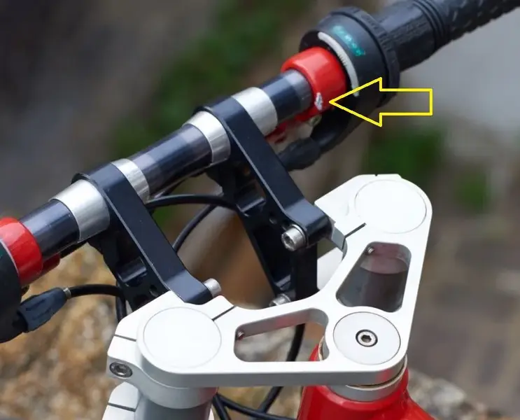

any here's the last stage just prior to un-masking
since the brake block fills the area so well - not even Magura appear to have worried about painting the block area, so masking up was pretty primitive.
Just need to give them a polish to get rid of the slightly orange peel effect on some areas.
You can still see which ones came from Foz as there just the slightest trace of blue in the treads, the other two were really crappy silver ones and TBH bin fodder before the make over.
Quattro Magura's ready for re-plumbing, in hind sight I wish I'd given them another coat of lacquer as in bright daylight you can see the edges of the waterslide on some however you do need to be exceptionally close - once fitted I'm hoping you'll never notice however its easy enough to either start over again or try another coat on them

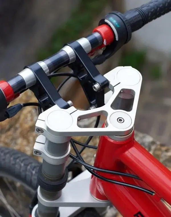

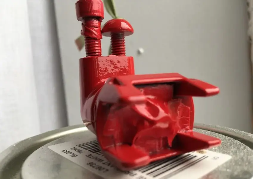

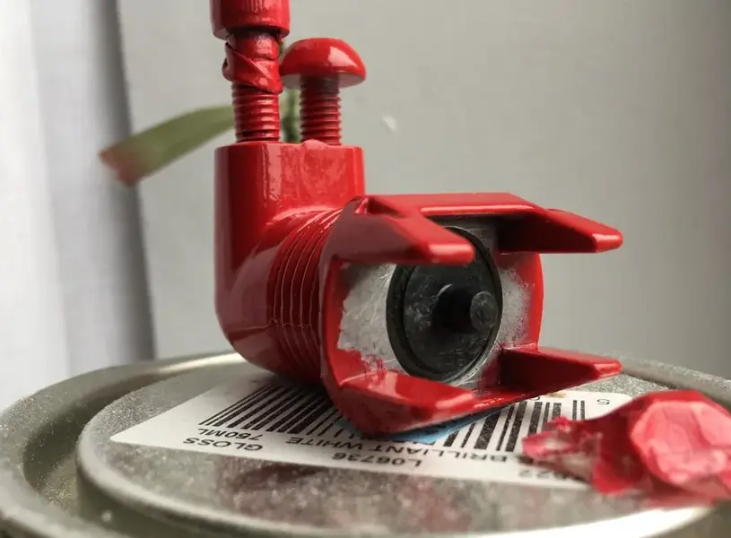

Whilst taking my Voltec forks apart to replace the worn out elastomers I needed to remove the caps fitted to the top of the stantions – just like Manitou I’s and II’s there’s a Allen bolt inside that needs a 36 inch long allen key to un do them, Unlike the Manitou caps which generally come out easily German tolerances were a lot tighter and made for a much better fit and after gentle taps with a re-purposed broken nylon tyre lever and a small hammer one came out but the other was stuck fast and in the end required much more force than was healthy which unsurprisingly lead to it being damaged and after the first gash to the Caps rim it lost its natural beauty and in the end looked like it was removed by a butcher.
and heres what happened when one refused to budge
Anyway the forks were duly cleaned and rebuild with new Elastomers from the USA – however I just couldn’t get past the damage I’d done to the top cap and using the info Thais supplied I contacted Steiner Designs in Germany on the off chance they might have a replacement for a 20 year old fork that I could purchase, and after an exchange of emails and some great information I’ve now got a replacement cap (last one) and best of all Jürgen sent it gratis – he even paid the postage !
and now I have a Pair and one tatty but functional spare

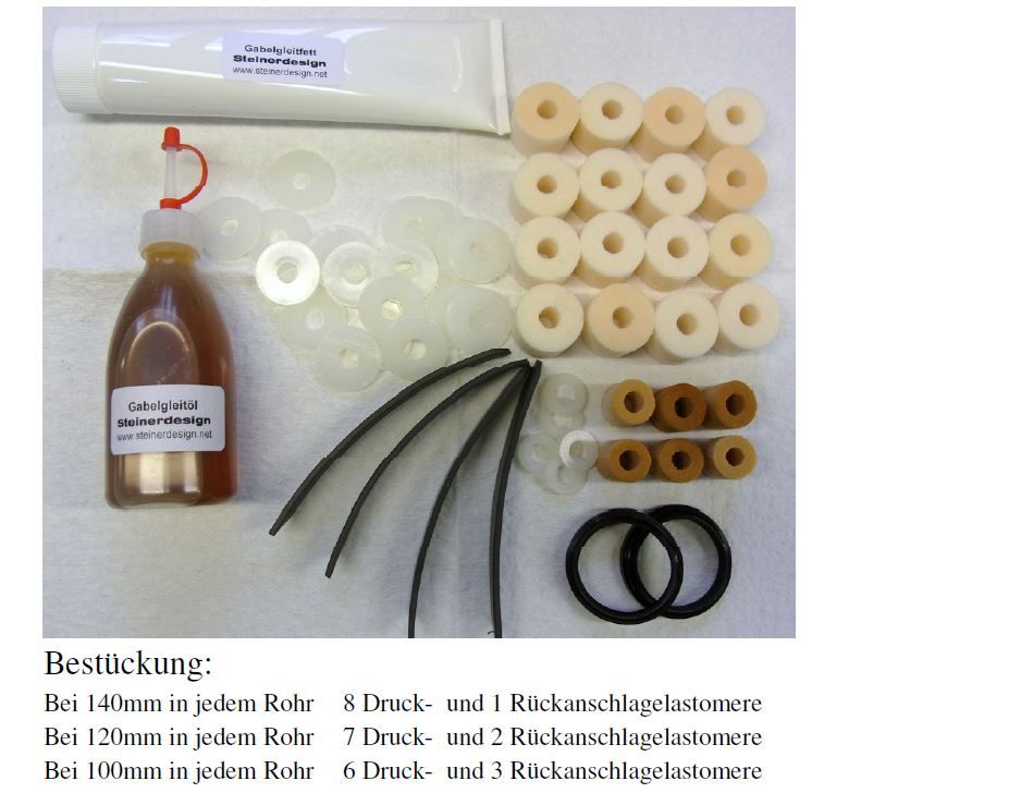

Just encase any one with Voltec III forks reads this in the future – below is the rebuild kit for them which is a darn site cheaper than Suspension Fork parts (even without US/UK import duty) and in this kit you get everything you need.
