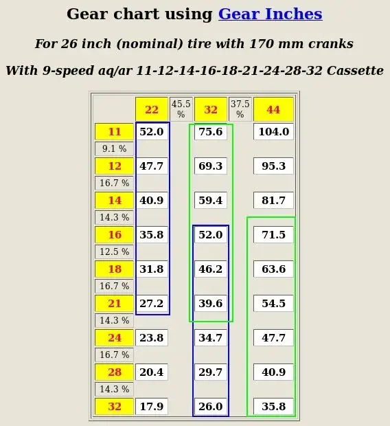

say you've got a 3x9 steup on a 26" bike
22-32-44 up front and a 11-32 cassette
If you ran it as a 1x9, you'd lose the fastest 3 gears on the big chain ring, and the 3 slowest granny gears on the little one:

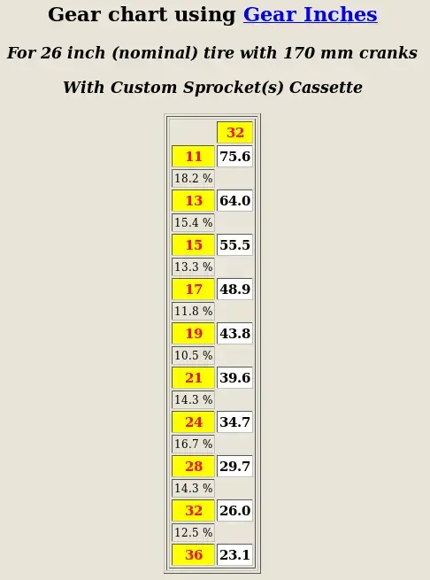

Say you were considering a 1x10 instead..
a 32 up front and a 11-36 10 sp cassette:
You'd lose the slowest 2 gears and fastest 3 on your 3 x 9
there'd be a lot less duplicated gears
