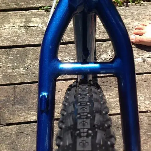

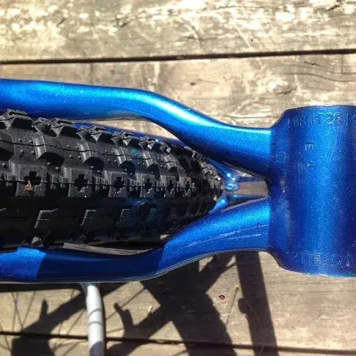

I'll snap a shot of the clearances tomorrow. It's not tight with the Maxxis 2.1 Crossmarks ... Only tight with be front dérailleur which I'll probably Dremel. It doesn't need the arm and that's the issue.
Forgot I had some shots of the clearances from before I got into the build.
It looks tigher on the chain stays, but there's lots of room.
