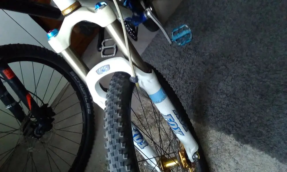

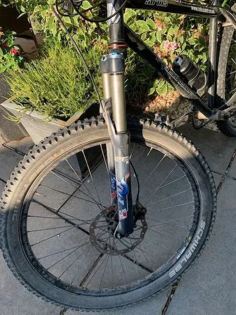

Now seemingly have two pairs of not working correctly Talas :(
The latest pair to fail are a 2006(?) vintage Talas RL. Owned for years. Never serviced.
Working fine until the last week or so.
Seems like occasionally - and now permanently - the rebound becomes extremely heavy to the point the forks pack down totally. Lockout now does not seem to work although Talas adjustment is still ok. On the back of a google search tested the pressure in the air spring whilst compressing the fork - seems to increase under compression as expected.
Pending a proper google search any ideas as to the issue? Is it likely Talas related (which might be the end of the forks) ? Or damper related?
Can anyone point me towards a service guide for this vintage? Assume I can service partially without getting into the Talas assembly?

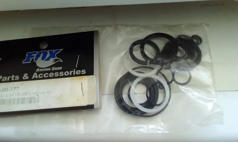

im still running a pair of 2008 Talas ll RLC
the service kit needed is shown above

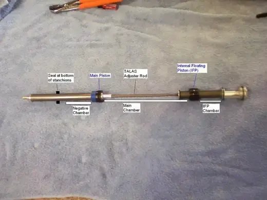

You would need to deflate and inflate the internal air valve ....there was a few threads back in the day to modify a football needle valve and use this on high presure pump to inflate .... I run my talas with a empty internal air chamber ... does not effect talas travel ..
these forks are quite complex to service took me 6 hours last time
Fox used to have Talas sevice on thier site in good detail

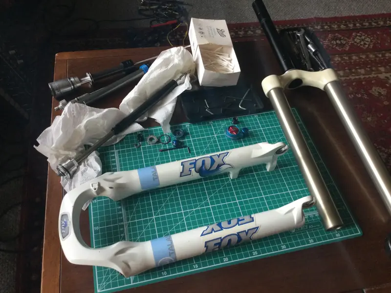

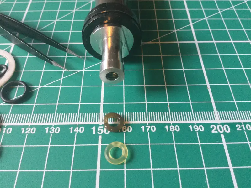

I restored my Talas Rlc on a complete budget .
Cleaned and soaked the old foam wipers and reused
I didnt have access to a vice or shalf clamps , i wrapped latex gloves and micro fibre cloths around shafts for purchase.
Used an old dustcap as a centering tool installing the top adjuster ring ..
Had oil and some float fluid and old seal kit .....
Forks like new again
Dont be scared to pull the talas spring its not that bad ....
