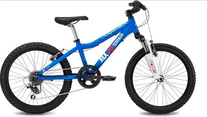

Got an opportunity to get hold of a 20" wheel with sturmey 3spd hub on it.
got me thinking - my eldest son (6yrs) is of the age where i want him to ditch the stabilizers (that's a work in progress and he is autistic so i'm having to be extra patient while i find a way to tackle that respectfully), aside from that, i know he will struggle with gears - but - more so, he will become frustrated with not being able to pedal up hill on a single speed.
i picked up a Ridgeback MX20 recenlty - wheels are in a sorry state, so ideally need replacing or ill have to invest time refurbing.
so - i put to you RBers - would a sturmey 3spd hub on a 20" wheel and 3speed sturmey twist grip be a good compromise for gears / would it provide enough range to tackle gentle climbs (we will mostly be riding gentle path routes - nothing trail like)....???
most importantly, is there any reason i couldn't get the Sturmey hub/wheel to fit the Ridgeback MX20...(since i'm guessing it came from a Raleigh shopper bike - the wheel is Raleigh branded)
thoughts and questions please - im going to pick the wheel up tonight hopefully - the chap is only asking for £5 for it so will get it in the hope that my idea is workable....
No problem at all with the concept. The risk is that the wheel will be 120mm spacing and the frame 135mm. There are axles available though. SJS Cycles are your best bet.
Seems to be a great idea. You might have to give some thought to the cableing though. Thinking back S.A. gears needed a pinch clamp on the chainstay to hold the cable.
If the gearing is too tall for him you can always swap the rear cog or even the chain ring. As above SJSC would be a good place to start looking.
Good luck with the build and I hope he has years of fun riding with dad.
EDIT Twist grip may be better, forward to go downhill, back to go uphill.
The rim looks like its steel, so that may hamper braking ... even when riding over wet grass. Bear that in mind, more so if he's autistic, don't wanna spook the little fella.
I spent my childhood on a 3 speed sturmey. It never needed maintenance, so is good in that respect, but it would forever slip into neutral between 2nd and 3rd. I'm surprised I had kids after that. And the standard ratios aren't that wide a range, so work out what cog equivalent the bottom gear will be. I think middle gear is 1:1 and bottom is 0.75 of that if it helps. Maybe check this, it's a long time ago.

A long time ago I read an article by a cycle mechanic who reckoned that S.A. hub gears never actually failed but were often lubricated with heavy chain oil which caused them to gum up and give problems. I'm not shure if S.A. gear oil is still available but that was what he recommended. I bet someone on here can add further information.

I'm pretty sure cable guides/attachments for sturmey hubs are around, or at least can be fabricated.
Could I use axle from the MX20?
Dont forget you will need to solder a stop onto the end of the cable where it fits inside the female barrel adjuster that screws onto the toggle chain for the hub gear.
The axle is hollow and if its old skool sturmey might have imperial threads for the nuts and cones. I'm no expert, but the guys in the road section would know better (if you dare venture there)
