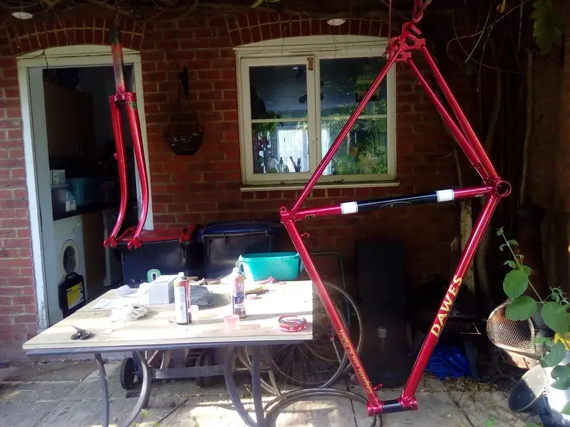

Thanks for the plaudits Peachy and yes that would be a pretty simple enough finish to achieve and that frame is crying out to be done.
The panels on the original are not metallic but the ones on wilfh's resto are metallic, it doesn't actually make any difference difficulty wise but I would say as the lighter colour is the main colour I would do that first all over and then paint the panels on top, had it been the other way round I would have done the panels first and then masked them and painted the rest around them, and of course use white primer. When it's got all it's colour on t-cut it before you apply your decals and apply your top coat as this helps with the transitions between the colour bands.
The only other tip I can give with this is make sure the paint you mask is totally dry before applying any masking tape and then remove the masking tape as soon as you can, something like that would take me about 3 weekends as I'd wait a week between colours but the masking tape would be removed very carefully about 15 minutes after the paint went on otherwise the glue eats into the paint and it doesn't seem to matter how good quality the masking tape is.
Here's a couple I've done with coloured panels. The Dawes was a challenge to do because the red is coloured lacquer so the sequence was do the white bands, wait a bit, do the gold base everywhere else, wait a bit, do the black panel, wait some more, do the red lacquer top coat, wait some more, apply the decals and then apply a clear lacquer top coat over that. It was for my best friends 50th birthday present and took bloody ages but he was pleased with the result.
The Raleigh I did because I'd never seen a ladies one, all the real team frames I've seen have painted yellow and black panels so that's what I did but a lot of the repro's are decals so an easy spot.
And yes the Campag bits just keep watching on ebay and at cycle jumbles and they'll turn up for a sensible price sooner or later.
