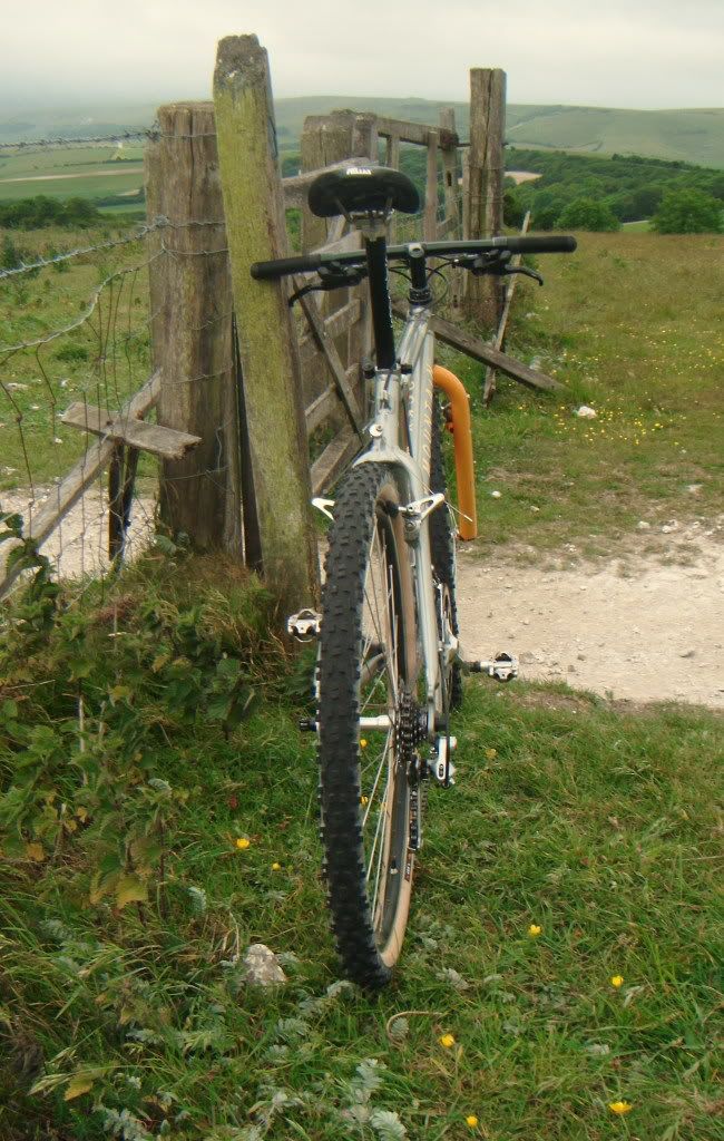

Well, been a while but have finally finished the Rocky Mountain Stratos :D
Took her out this morning for her first run and, apart from a slightly loose headset, she rode like a dream - pretty light, really responsive and just glided up the hills. The set up is pretty steep but actually found it a really comfortable ride. So, thanks to everyone who submitted parts and advice, here she is back on the trails where she rightfully belongs..
(Will do full spec sheet later on today)

Thanks for all the nice comments guys, really appreciate it.
I raised the stem a notch and sorted the headset today and went for another spin. Just LOVE IT!! Really proud to be a Rocky owner...I have come a long way in a very short time :D
