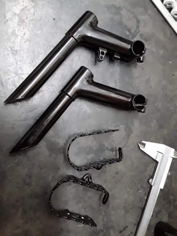

stems are back.....nicely filet brazed and now powered too. The roller is for this bike the other for my "91 team marin touring" bike project (see other thread).

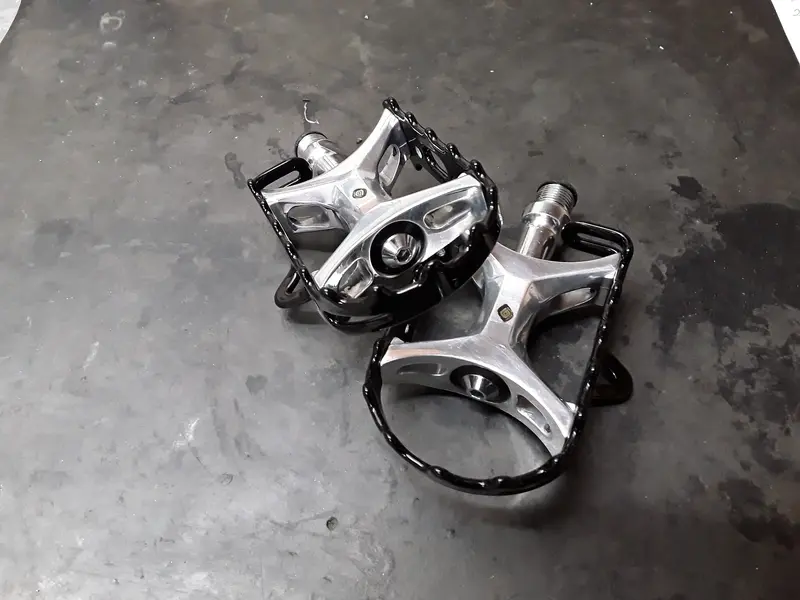

I've also finally finished my suntour xc9000 pedals for this. These were the last generation of these and share the wtb greaseguard body that was used on the xc pro range.
These were in a right state..rounded off flats, scratched to death, bearings shot, spindles in need of replating...whats not to like there🤣
They have been quite a job in the end. But they are now spot on and cheap.!
Bearings were a couple of quid, flats were ground down from 15 to 14mm, I actually bright zinc plated and polished the spindles at work in the end...the cages were sanded off and powdercoated, bodies filed, sanded and polished. Normally i go for cerakote on cages but i wanted to hide the deeper scratches I couldn't get out.

Im pleased with the result. They are good quality pedals and deserved a new lease of life. Sometimes I do wonder if I have more belligerence than sense all the same. 🤣

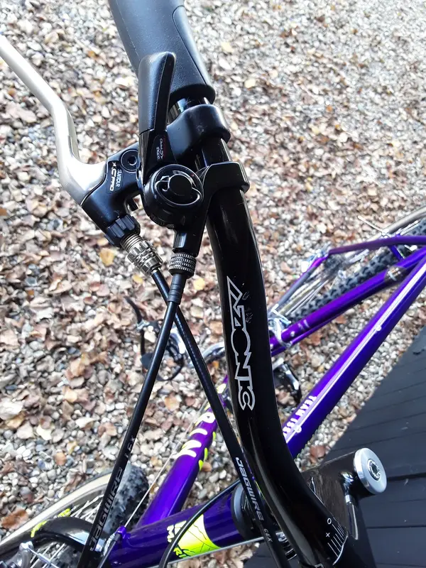

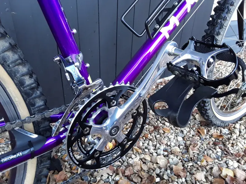

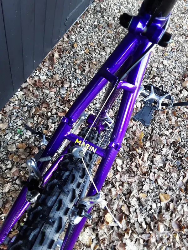

Stem bolts turned up and after a quick break walking round the lake district (me...not the bolts)...im back at it.
Stems in and we are finally getting there.
Bit of bar twiddling, grip shifting, lever fettling etc and we have a winner....well I think so....... in that the grips are now 45mm higher than the saddle, and the stems not looking too stretched out / high.
Think the double wall at the top helps loose the length as I hoped.
I know it wont be everyone's cup of tea (stem and bike), but if this option keeps me on the bike and on 26" in general, that's a win in itself.
Its taken a while, but after some fettling, it's finished! Huzzah!
So here are a few pics....
I know its not everyone's cup of tea, but hey, if you get it you get it.
Im really happy, its all day rideable, light, the frames an absolute peach too.... responsive and alive, you can feel what's going on and it has that prestige "twang".
And in the sun that paint really does change colour and pop.
