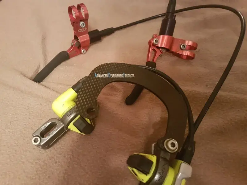

About the lightest way to run Maguras is Kooka levers and ADP Carbon braces.
Re: 93 OCLV weightweenie Project *Shedding more weight*
LOL. Way ahead of you there... Kooka levers and no braces :)
