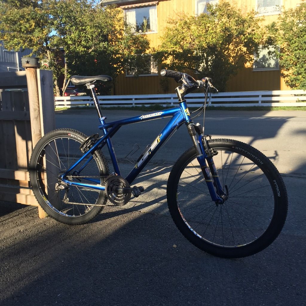

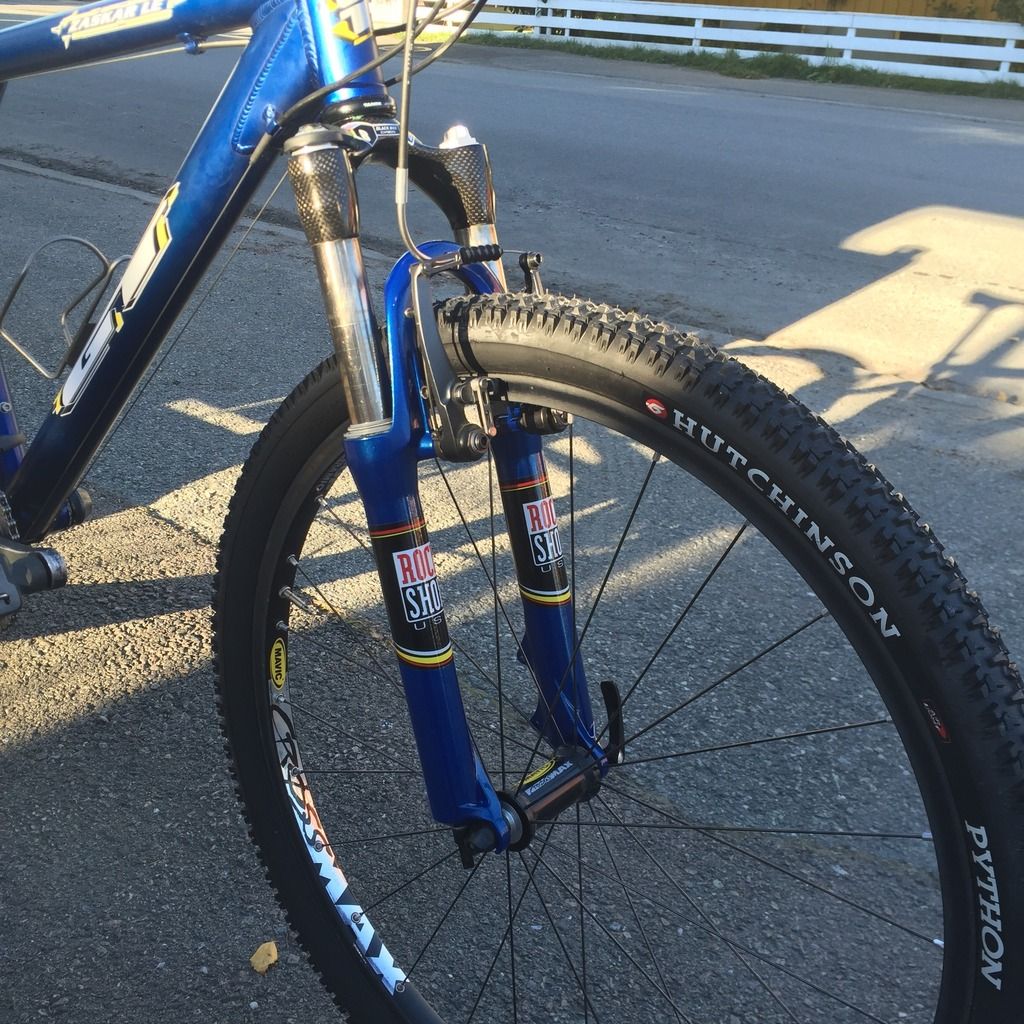

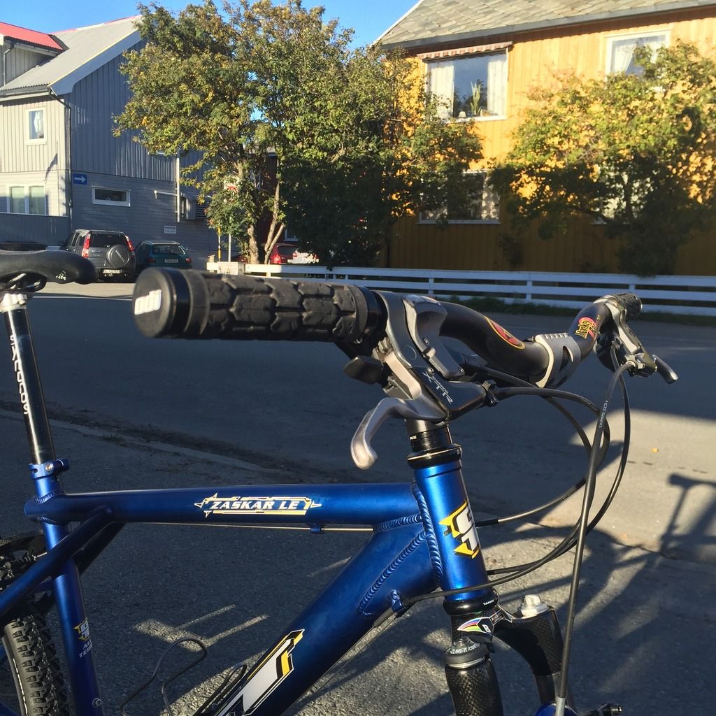

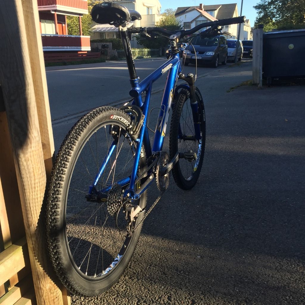

Just finished my '98 GT Zaskar LE frost blue build. I've tried to keep the specs as close to the original as I could, but I put on some of the components just for my personal liking. Also, the fork is a 2002 Rockshox SID SL carbon with '98 SID decals and a fresh paint job.
Spec list:
Frame: 1998 GT Zaskar LE frost blue ano 16" 6061-T6 aluminum
Headset: 1998 Tange
Fork: 2002 Rockshox SID SL carbon with 1998 decals and a paint job to match the frame
Cranks: Shimano XTR M950 172,5mm with the original M950 octalink BB from '98 (!)
Front mech: Shimano XTR M952 bottom pull
Rear mech: Shimano XTR M950 8-speed
Shifters/brake levers: Shimano XTR M950 8-speed
Brakes: Shimano XTR M950 with Shimano carbon brake booster on the rear
Cassette: SRAM 8-speed (going to find a XTR M950 8-speed later on)
Chain: SRAM 8-speed
Saddle: Selle Italia Flite
Seatpost: Syncros 27,2mm
Handle bar: Easton EA70 Monkey Bar 685mm
Stem: Syncros with hinged handle bar clamp
Wheelset: Mavic Crossmax mk1
Tires: Hutchinson Python
Pedals: Time A.T.A.C.
Pictures:
Had the maiden voyage on it today, and it feels absolutely amazing.
