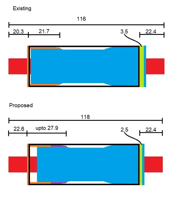

I am now wondering if there is a "simple" engineering solution to this. If the biggest problem is the support of the bb in the frame, or the lack of it, if a 68mm unit is used would a longer cup on the non-drive side solve it? The thread in my frame is 27.9mm deep and the current cup is 21.7mm including taper, so that would take care of the 5mm difference.
Now please don't laugh but I done a little sketch of my thinkings. If it would work i am not sure how to best "extend" a cup are different lengths available, I can't find any info on them if they are. I could just use the band saw and create a simple mechanical joint, a step would do it. The advantage of that over brazing would be that each piece could find its own way so to speak, brazing it so the threads match spot on I think would be very very difficult.

This seems far more complicated than just getting the correct bottom bracket for the application. It'd even be simpler to swap the chain set for a square taper unit for which you can still get all the different combinations of BB if your old hollow tech one is hard to come by.
I agree, but I am cant find an exact replacement. Also I don't want to change my cranks, they've been on the bike for the last 19 years!
One thing I haven't done which I probably should have, maybe first, is ask if anyone here has one they would part with for the appropriate amount of beer tokens!
Just remove the old bottom bracket, and buy one exactly the same :lol:
For the old type square taper cartridge bottom brackets, if your frame has a 68mm BB shell get a 68mm BB, if it's a 73mm get a 73mm.
The axle length is determined by the cranks you want to use, there's lots of different ones. But if you're keeping the same cranks then just get a BB with the same axle length as the current one (or look up the recommended axle length for your cranks)
Only 2 things to remember...
BB shell width.
Axle length.

Ditch the obsolete standard and get a new chainset. It's one thing to be attached and keep a bike standard, but sometimes you just have to let it go. It not like it's an old xtr chainset, it's only a specialized OEM item.
