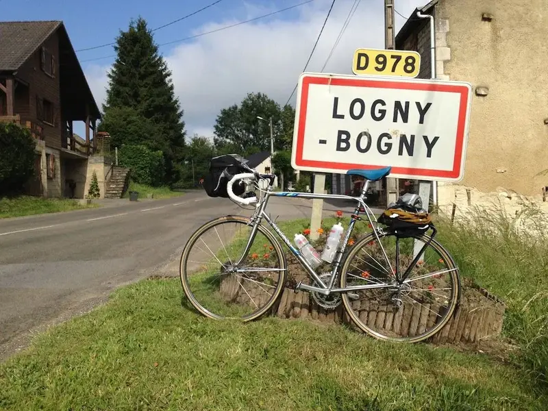

I wouldn't get the Vittorias although they are a lovely tyre to ride and look good too, they won't last very long. I use them on my audax bike and get about 2000km's on the rear before it needs changing.
Ok if you've got the cash though and they do grip good and proper.
Here it is sporting the Vittorias at Logny-Bogny, Belgium
Sweet setup!
Do you think the load of the Audax is causing the wear? I have about 2000km on mine, and only the very fine herringbone tread is gone in the centre, but lots of rubber left. Front looking pretty much new. Smooth roads around here, though.
Anyway they seem to be gone from the Vitto 2015 catalogue, for shame.
