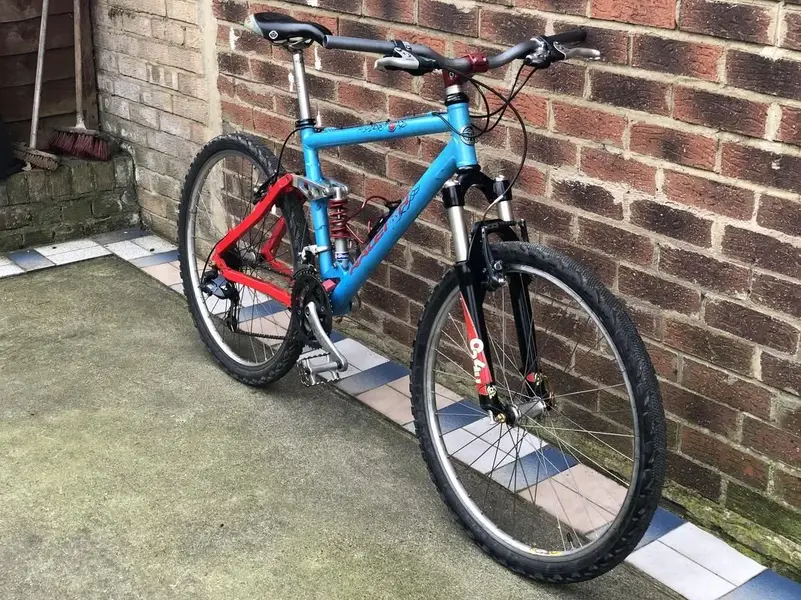

The bike is this one and I guess has front mounts for disks on the forks but not sure about rear - I’ll have to check tomorrow

Just had a look at a Raleigh catalogue from 1999 and another from 2000 - the full sus bikes with F and R disks use Mavic Crosslink Disk wheels - things are clearer now! Thanks for your advice and help - always appreciated! Now I’ve got to find out whether these have rear mounts.
I guess a Mavic disk wheelset or Hope - I would like to go with magura brakes to match the forks - what’s diff between Clara, Louise and Julie? And would the mavic or Hope wheels be compatible with these?
