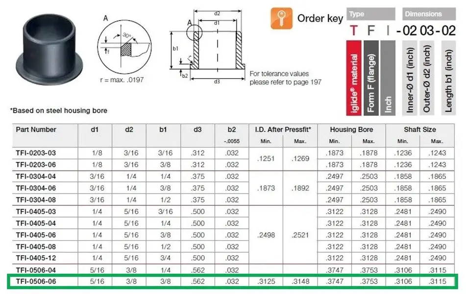

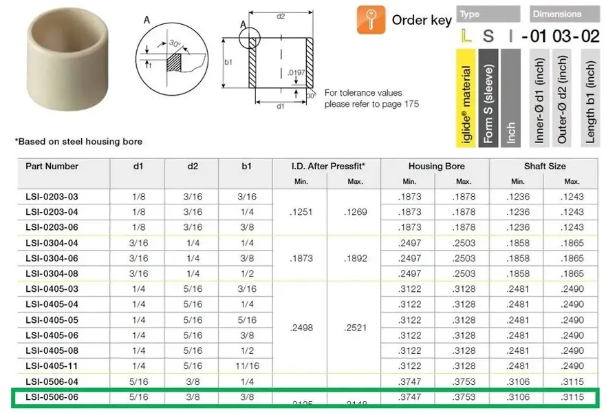

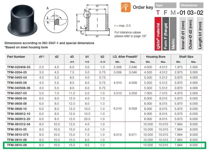

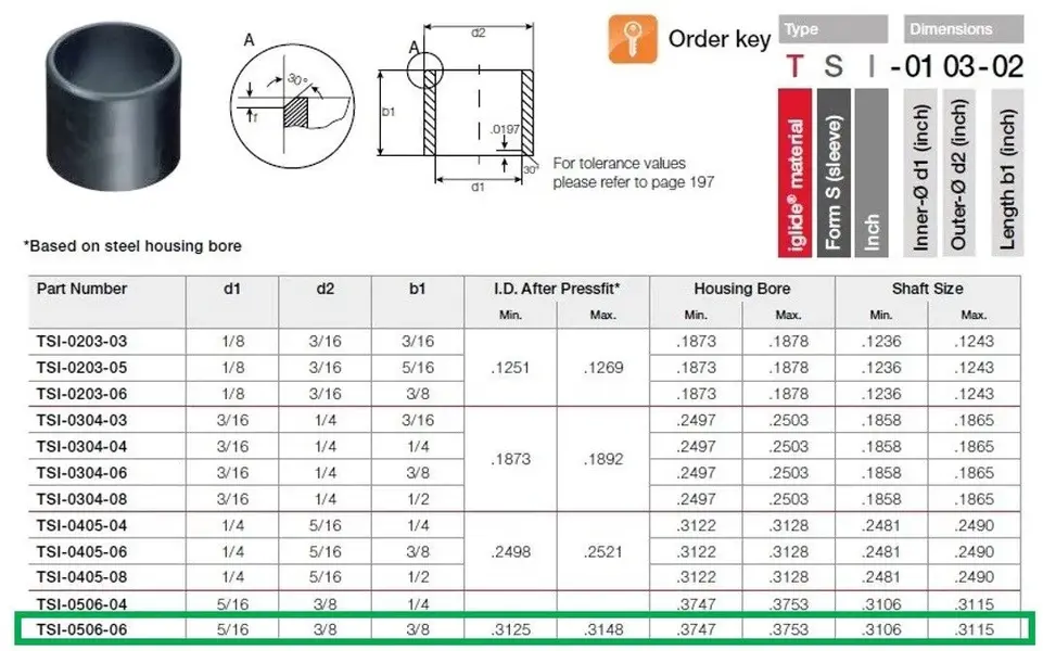

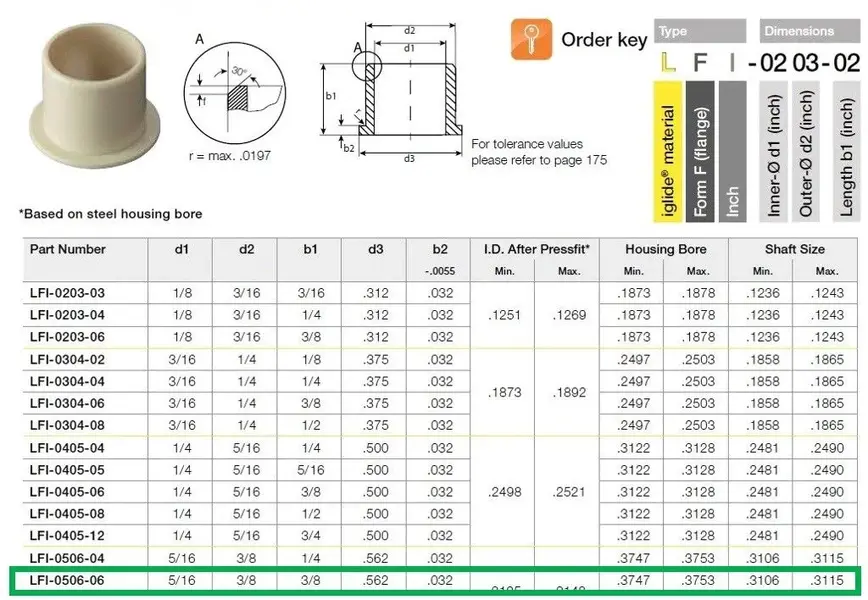

Yes we do, but there's a mixture of Imperial and Metric. You would have thought they would stick to one measurement system but the dimensions are close, so what's right? There are five types;danson67":3sefxvaf said:Do we have dimensions?
1. TFM-0810-09
2. TFI-0506-06
3. LFI-0506-06
4. LSI-0506-06
5. TSI-0506-06
(5/16" = 7.9375mm, 3/8" = 9.525mm, 0.562" = 14.2748mm)
All are made from Iglide®; "T" = T500 and "L" = L280, which is the grade of bearing material.
