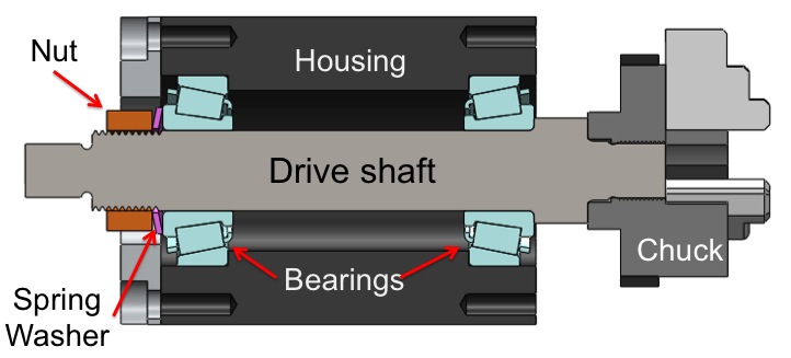

Your bottom bracket has a lot more in common with a lathe spindle than a conventional bottom bracket see the attached photo, instead of a lathe chuck imagine a crank arm and chain ring. Timken bearings are shown in the photo, imagine annular contact ball bearings instead. I believe whoever designed your bottom bracket spent time in a machine shop as it's constructed like a lathe spindle.
Let's assemble the bottom bracket, first the outer bearing races are pressed into the bottom bracket shell until contact is made with a step or shoulder internal to the shell.
Next the right hand inner bearing race is pressed on the right hand side of the spindle against the shoulder and then the ball bearings and retainer is placed on top of the inner race and inserted as an assembly into the outer race through the right hand side of the bottom bracket.
The left hand ball bearings and retainer is set in the outer bearing race and the inner bearing race is a slip fit over the shaft until contact is made with the bearings and races.
The two nuts controll bearing preload, the snap ring, dust shield, and felts are not a structural part of any of this and only keep the grease in and the weather out.
The bearings in your bottom bracket are similar to the type used in Maxi-car hubs and old school high speed rotating machinery, they are very stout and handle axial and thrust loads. Your bearings have numbers stamped on the edges of the races and should be available at any good bearing house.
I hope this helps, the reason I said "Wow!!!" in my first post was I recognised the construction from my machine shop days. :shock:

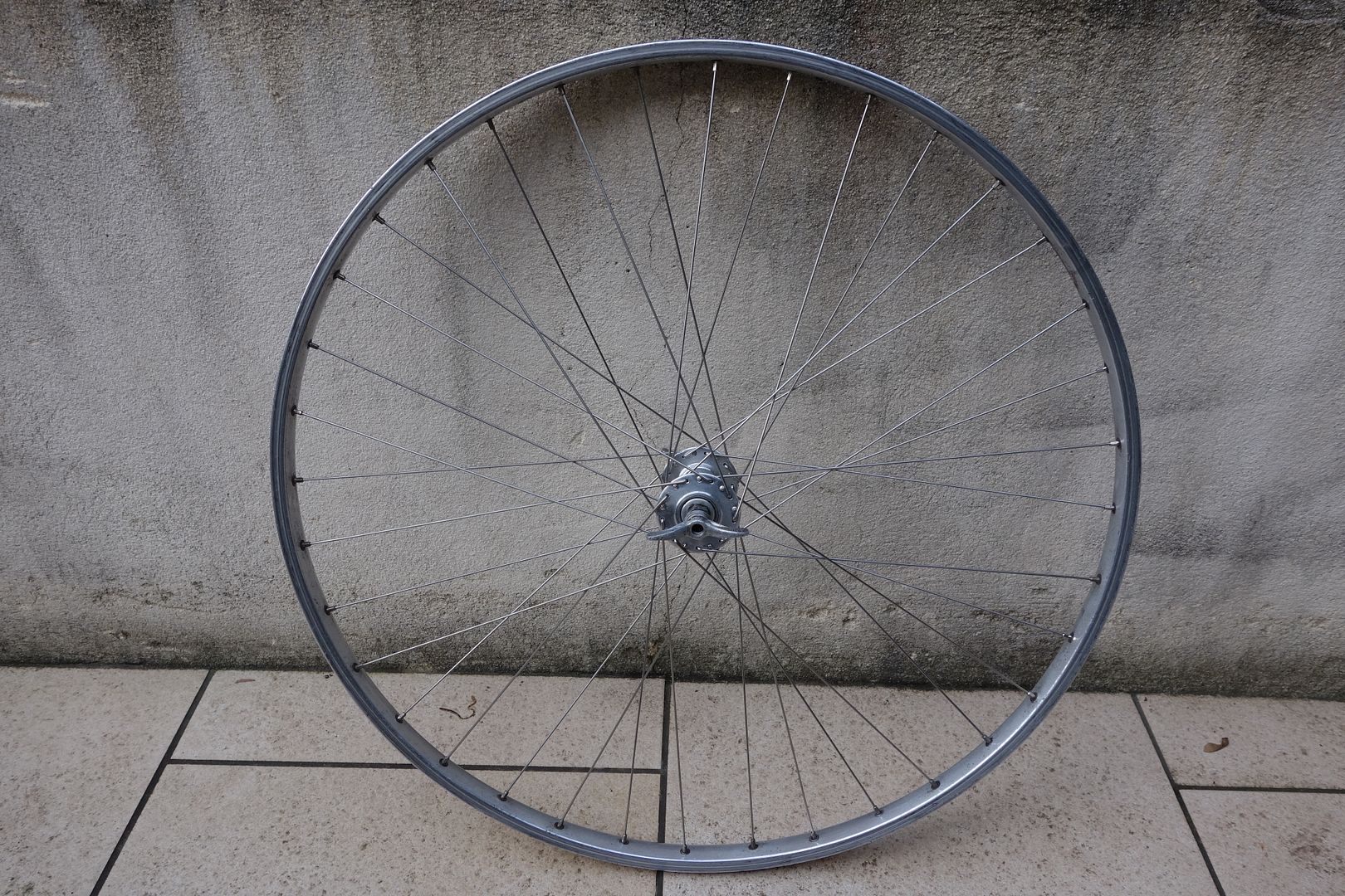

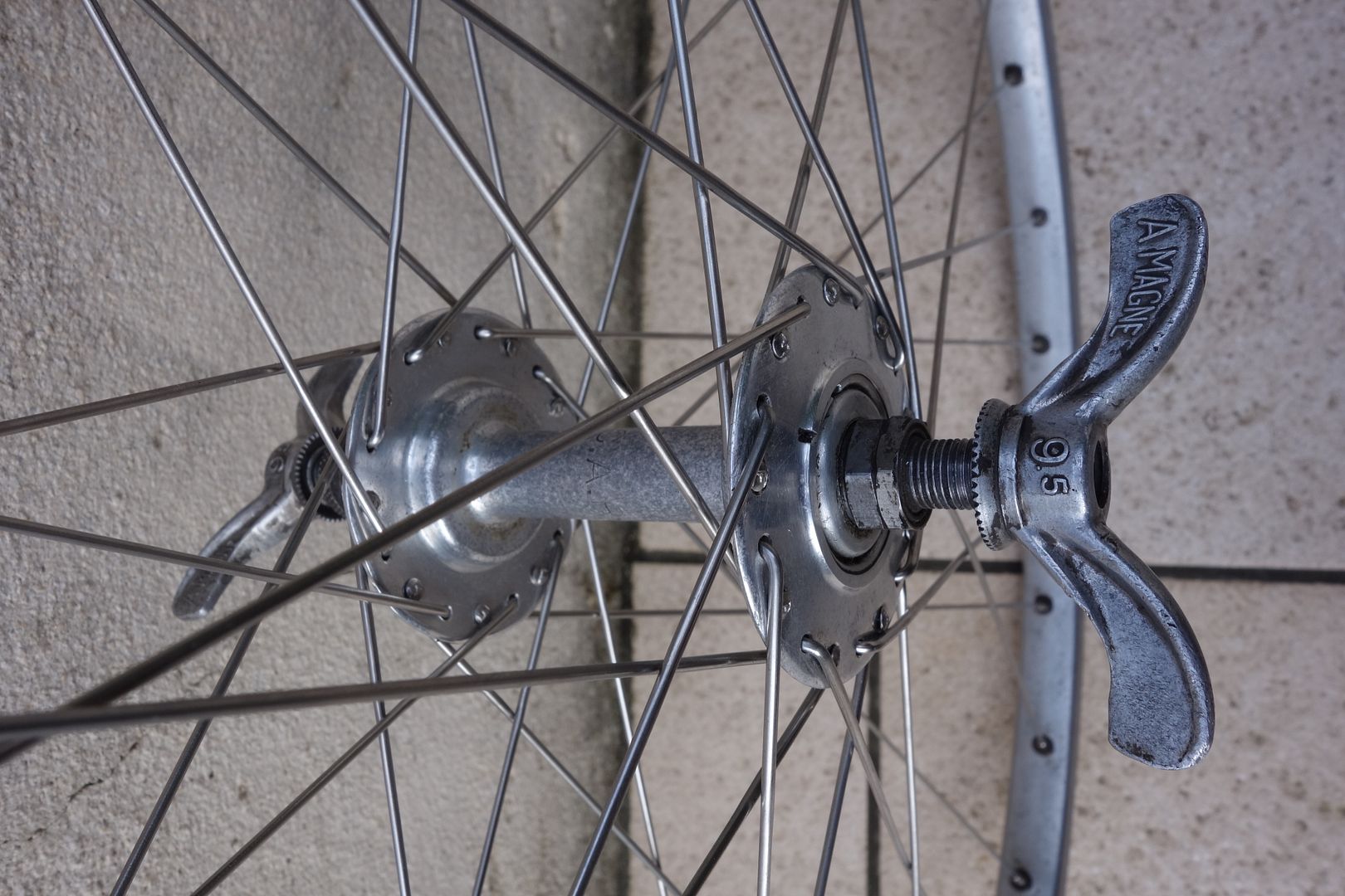

I said that I purchased some DT competition 2/1.8 spokes for my rear wheel.
Alas , when they arrived I realized the flanges could only accomodate 1.8 spokes - the hole was not big enough :roll: - remember initial spokes were 1.8/1.5

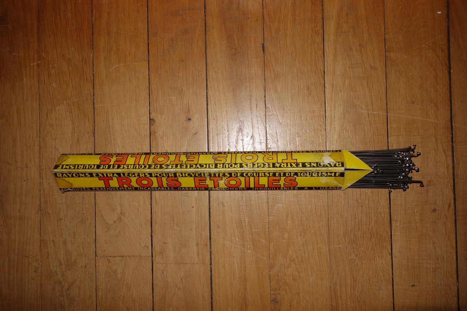

I also said these Robergel spokes were as rare as a hen's teeth , I have been looking for some for ages in France
well by sheer derision , I made a call to "Saint Expedit" patron of the lost causes in France :idea:

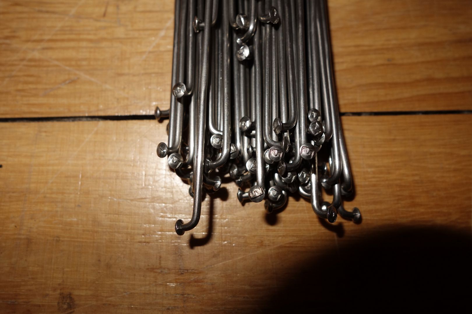

A week after, by sheer luck , I found an old box on the major small ads site in France that should do the job- they are 1.8/1.6 - they were advertised as 290 mm but by reflex I checked and found them to be 305 which is about the right length - its about the first box I seee in the last three years 8)
So the poor "lost sheep" I am is now contrite and I'll light a candle next time I go to church :oops:
