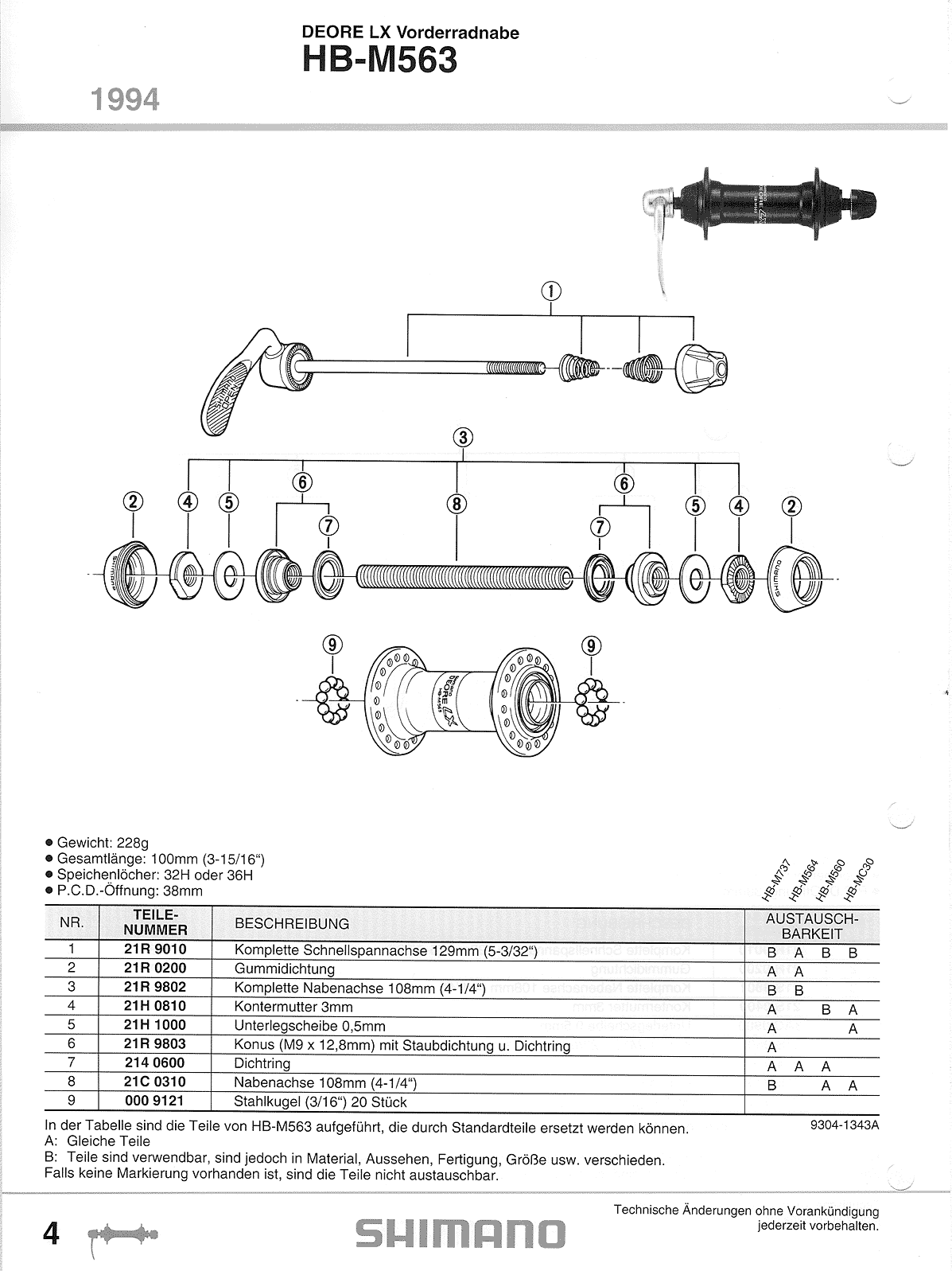

just found out that im a ball bearing short of a full hubs worth.
Tell us something we don't know :P :lol: :lol:
3/16th is what youre looking for. Bog standard,easy to come by.
Serviced a black lx front nigh but a couple of months back. Got them from the lbs.
well, turns out i just needed to look a bit harder.
found the missing ball bearing inside the mid section of the hub....
problem solved.
:oops:
:facepalm:
:facepalm:
Rampage":297hpeun said:
There should be a gap between the bearings?
Should be 9 in a Shimano front IIRC.
10 each side for these, rears are 9 each side.
The grade 25 Shimano will be original shimano bearings, probably stainless steel at xt/xtr level.
Most 'shop' ones are lower quality grade100.
Anyway,thread useless without some pictures, so here's the techy bit.
