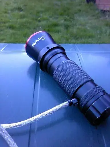

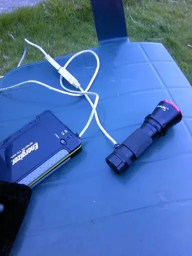

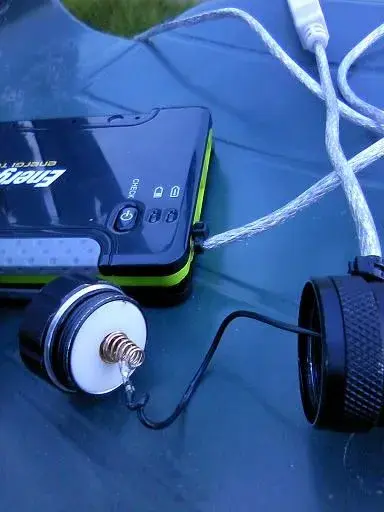

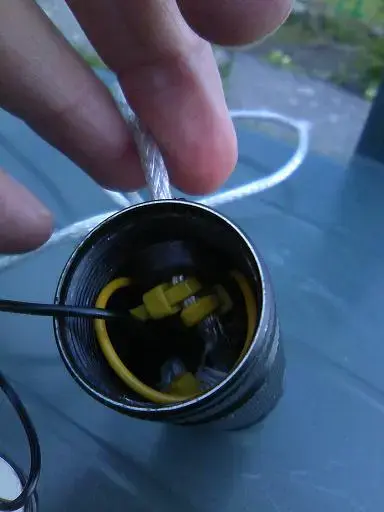

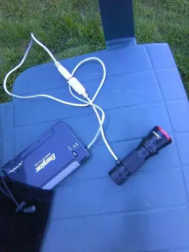

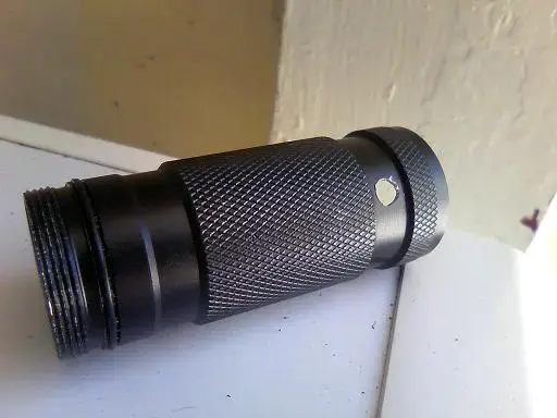

Thanks to the fab member, I got one of these lights finally. Just experimented, and drilled a 4mm hole in the body and cut up a usb cheap extension cable for external power connection. (I am using 4000mah lipo battery pack, so hopefully 6 hour run time with the R2.)

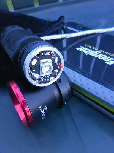

Installed the XR-E R2 without the 1000ma driver as it seems there is already a driver imbedded in the button.
Will have to try and get that out so I can run the 1000ma driver.
Pictures tomorrow, but be warned, bad soldering and cable ties lol. Just a note: Realised that without the driver installed i have lipo voltage protection so will need to sort that asap!!
Here are some photo's. No bike/helmet mounted shots yet, but will do.
Please bear in mind this is just my first try and is experimental to see if it will even work. Bad soldering and cables ties abound! Also, no night shot's as my sucky phone won't actually work in the dark to take pics. Will get some though. Suffice to say it's pretty damn bright though, and hopefully will be brighter if I can suss out how to remove the original flashing driver.

And the rest:
NOTE: See pic "ebay 5W Cree 6.JPG". The on/off cap is the only place the LED driver can reside, so I will have to try and pry it out at some point and just make it a button, so I can put the driver next to the led. I jsut wanted to get a Proof of Concept done first :-)
Hoping the light will run about 6 hour's from this pack on full (compared to around 80/90 min's on triple AAA's.

Yeah, the light turned up on Friday, and Sunday was the first opportunity I got to have a play, whilst at a BBQ. Borrowed a much to big soldering iron, and did it in the garden on a rock lol.
I had to slightly file down the pointy bits of the XR-E star PCB as it was slightly too big, but fits fine now.
The only issues I see at present are that due to the LED being mounted about 1mm higher than the stock LED, the len's is slightly distorted when trying to tighten down the head. Not too sure What I'm going to do about that yet.. But I'll think of something.. cheap, lol. The other issue is obviously the Driver PCB being built into the original switch.
Incidently, if you do want to change driver.. it's possible it could fit directly behind the LED.
