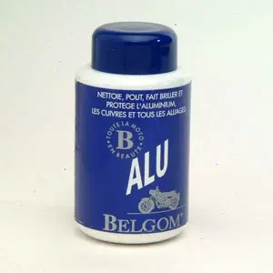

"Belgom" not sure if this is available in the UK though
