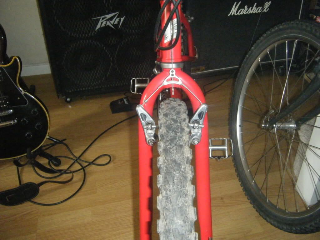

Don't know about / never had straddle rods :-( if we persume the cables dont actually stretch under braking, I can't see any advantage (other than they look cool 8)) and you actually loose the ability to mess about with hanger height ?
Any how, wide canti's and a low hanger :
We could do with a similar frontal shot of a low profile setup for comparison :D
WD :D
Here's some low pros; M734, Smimano M-System pads:
