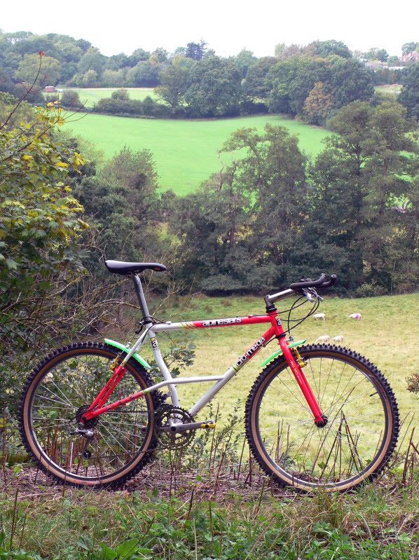

I, myself, am tall but have short legs for my height (though my knuckles drag on the ground when I walk!) so I prefer 18" frames with long seat posts and long stems; my cro-mega for instance, has a 160mm stem...
...and although I am 51-years-old this bike fits me like a glove and I still don't suffer from back/neck pain 8)
