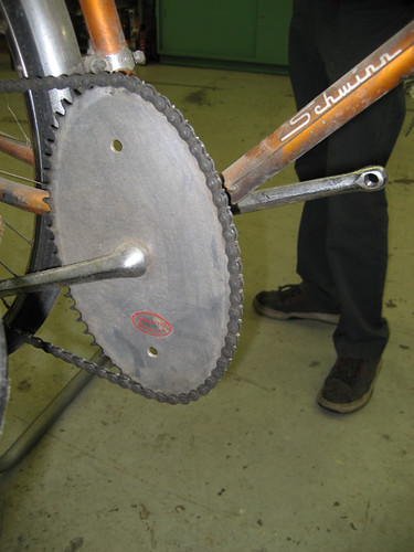

To be factory correct you should align along the length of the crank BUT to make them work properly they should be turned through 90degrees (or as near as you can with a 5 arm crank).
Shimano were wrong, badly, with this one. The point at which you exert the most power is the bottom section of the down swing of each crank arm, it's where you really stamp down on the crank and so it makes sense that this is where the high inches and therefore the widest part of the ring should be. All other decent ring makers knew this:
Durham bullseye in the 80s:
Chris bell in the 90s:
Osymetry in the 00s:
Shimano f*cked it up so bad that it took an entire generation before racers were willing to try ovals out again! Get them the right way round and they feel great, put them the Shimano way and the oval effect will feel odd as their orientation will multiply the oval feel rather than it smoothing out the pedal stroke!
