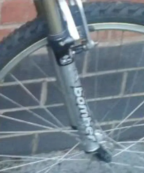

My buddy picked thus up at the weekend. Not familiar with the forks. They're a bit soft and have valve both sides next to the canti bosses. Do I pump them up? Both sides? And if so how much?

Superflys, 1999. Top of the range that year ;-)
Either take the brakes of and pump up, it'll need to be able to depress the valve.
Or if you want to leave the brakes son, some flexytubes fit else they used valved angled extension.
You'll also need a long allenkey for the damper adjustment in each lower leg.
The document above and many others are in the archive, mainly as I have them forks so put it all there some years back.
http://www.retrobike.co.uk/gallery2/v/M ... Marzocchi/

Just be careful tightening the bottom nut when you do get some orings (just measure them). The bottom 'bolt' snaps pretty easily as you don't notice how tight they really are.
Most auto parts stores should be able to help you with the orings. Or a hydraulic shop.
Fluffy speaks the truth on the bottom bolts. Snapped one myself back in the day, just "snugging" it. 2 finger snug is snug enough, turns out....
