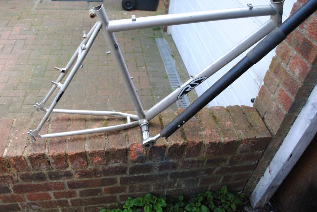

I'm trying to remove the bb from my 94 Lava Dome and am having some trouble. Basically its stuck and when i tried moving the drive side, the teeth on the ring jus desintegrated. Its an old square taper type, probably the original. Will this come out or am i buggered?

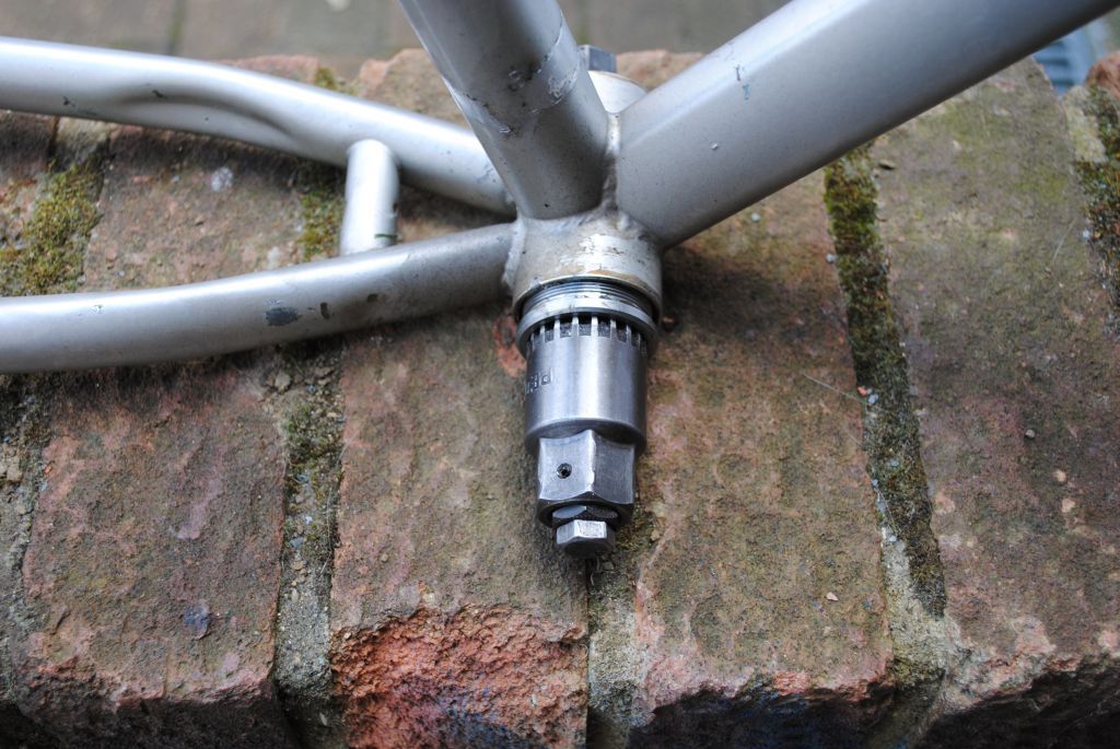

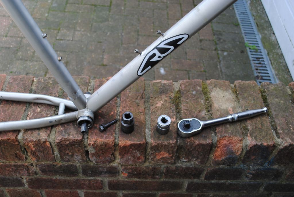

1. not all cartridge BB have the threads on the conventional side - your LBS should know that, some have the support cup on the drive side so appear to be 'round the wrong way'
2. you should always undo the cartridge bit first, the support cups disintegrate - see my guide on how:
http://www.retrobike.co.uk/forum/viewto ... ight=guide
To add an additional support, use a g clamp or similar to hold the tool in place as they tend to "pop" out. Once clamped, you can tug away and get the bb out.
I had one that was properly installed and greased. soaked it (an entire tin) in wd-40 overnight. I was not seized, just 'king tight.
also if the bb is original, the main body will come out with the left hand cup, unlike most shimano bb's, where it will come out with the rh side
