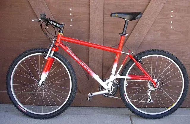

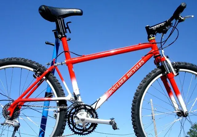

I am getting ready to put my Boulder on eBay tomorrow but I don't how to identify the model. I think it was made around 1991. It has the original fork (which is a Rock Shox RS-1), so that seems like Gazelle. The serial # is 00091, which means nothing to me. The guy I bought it from called it a Defiant, but he wasn't the original owner and didn't strike me as someone who knew much about these things.
Help?

Hahahaha busted!
There is a legitimate question in there, though. Is there a way to tell the difference?

Its early enough so I'd stick my neck out and say Gazelle. Shipping going to hurt- it cost me just shy of $400 to get my FAT sent over and that was when we got $1.75 to the pound. Boulders don't seem to make themoney they should as it is- with such a big chunk to go on top for shipping I would be mighty suprised to see it land this side of the pond.

I am going to call it a Gazelle in the ad. All of the original ads that I've seen for the Defiant say it was offered with a Mag20, not the earlier RS-1.

erkan":5a1d76l3 said:
Defiant and Gazelle are the same frame, just different name IIRC.
Not quite, I've had both, and there are a couple of subtleties. .

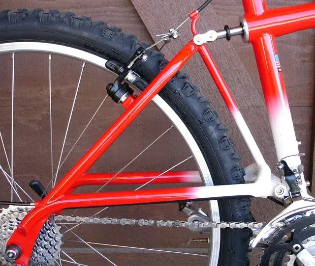

Yup, thats an early one going by the paint and serial number, and RS1. My Gazelle was similar. The EARLIEST gazelled had a seat tube not in line with the seat mast, giving a 'bent' look. If its Bent, its a gazelle. But the later gazelles were 'straight'. And 1 1/4 headset.
On the Defiant changover, going by mine and OCDGeeks Defiant, the defiants were 1 1/8 headtube, not 1 1/4".
And if it gets the cast gazelle headtube badge, its a defiant, as this headtube badge is pretty late. Early headbadges were either absent, or a 'wheel behind a mountain' graphic.

Oh , I forgot to add! Gezelle and defiant:- the gazelle was corrected for the loooooong RS1 fork, and the Defiant was corrected for more contemporary mag 21/ Manitou2 generation. .
Being that this is on RS1, it kinda MUST be a gazelle. A defiant hadles like a chopper on RS1's. . :wink:
